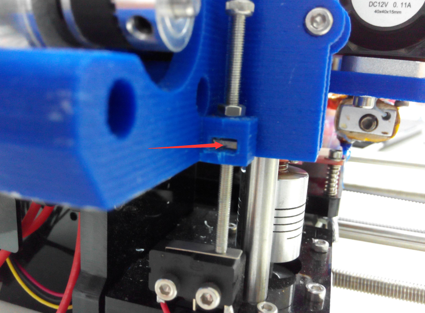

Hi, retaf99
1. There is a square nut to fix the screw. Look at the picture.

Thank you for posting that picture as I did not even know that the bolt was supposed to be installed, it is not in the instructions at all. I was speaking of the screws holding the limit switch itself. There are no nuts for them and the holes are not threaded.

Sorry, my bad.
There are 2 nuts used to fix those 2 screws.
