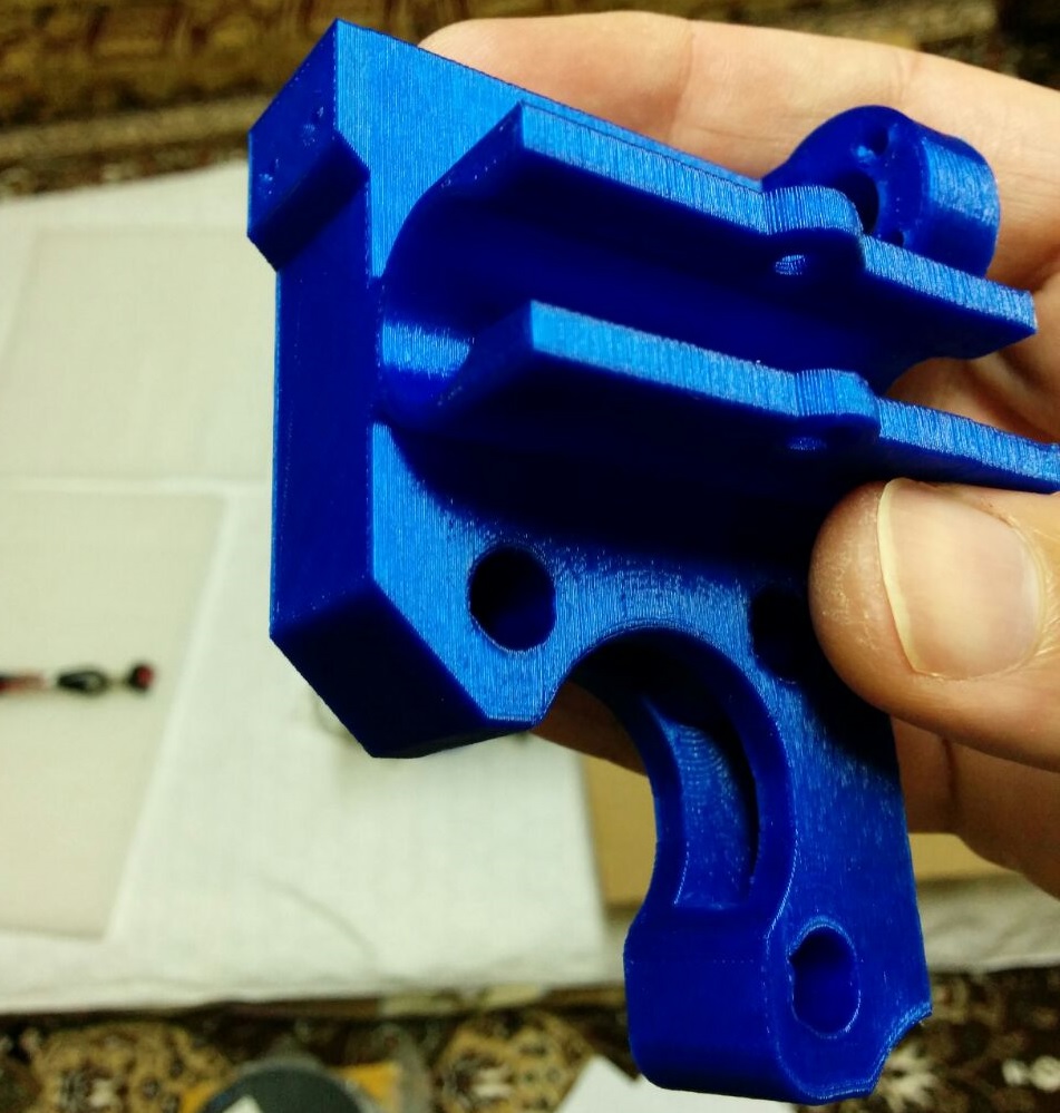

My printer is Acrylic Pro B and since I got it I am trying to reach similar quality as some of the parts your sent with printer (see the image below), but with no success.
What printer did you use to print these parts and with which material?

Hi,abulafi
We use Prusa i3 B to print these parts.
I think it's not the printer quality issue, it's because your slicer settings are not so good.
Please tell me you filament diameter and nozzle diameter, I can share my own settings with you.
Re: Printing Quality
Posted: Mon Mar 23, 2015 5:32 pm
by abulafi
Filament: 1.75mm ABS and PLA.
Nozzle: 0.3mm
Posted: Mon Mar 23, 2015 5:35 pm
by zhangxueyou
Please download the attachment. Hope it will help you.
slicer settings(1.75-0.3).zip
(681.31 KiB) Downloaded 711 times
Posted: Mon Mar 23, 2015 5:38 pm
by zhangxueyou
The part in you picture is printed with PLA

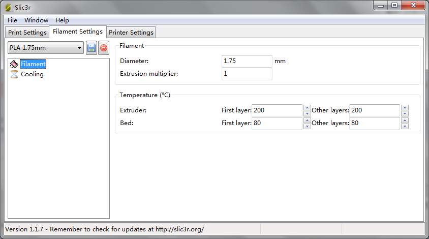

Posted: Mon Mar 23, 2015 5:54 pm
by abulafi
Thank you for information.
But these settings seems to be for ABS, isn't it?
I noticed that from the heatbed and nozzle temperature.
Posted: Mon Mar 23, 2015 6:06 pm
by zhangxueyou
Actually , the main difference between ABS and PLA is temperature. Look at the picture:
Posted: Tue Mar 24, 2015 1:44 pm
by leonardo.galardi@gmail.com
Using the setting you sent I had an enormous improvement. See the results :).
Do you have similar settings for 0.1 mm PLA?
Thank you
Leo
