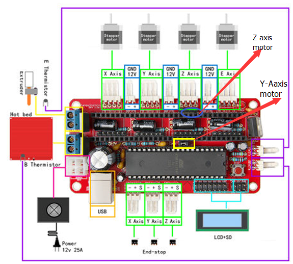

i follow the manual you give me and connect it like this
http://www.geeetech.com/wiki/index.php/ ... _pic86.png

As you can see in the picture, there is still another connector for z motor(above the 3rd A4988) , but you need the extend the z motor wire with a 4 pins Dupont.

i think i know my mistake i plug the second z-axis motor on the e-axis but now i think the e-axis is for the motor of the extruder and if im right i just have to switch it
