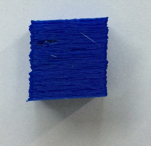

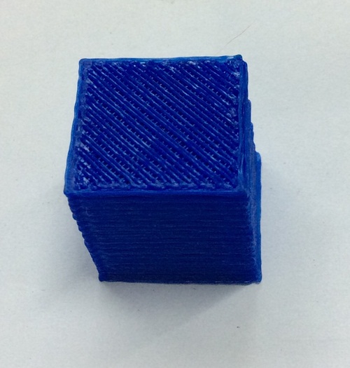

I just test stl file
1. cubic 15 mm^3 , I take a photo as attached this cubic has distort in Y-Z axis (look slope but truly must vertical )
How I fix or setting this ?

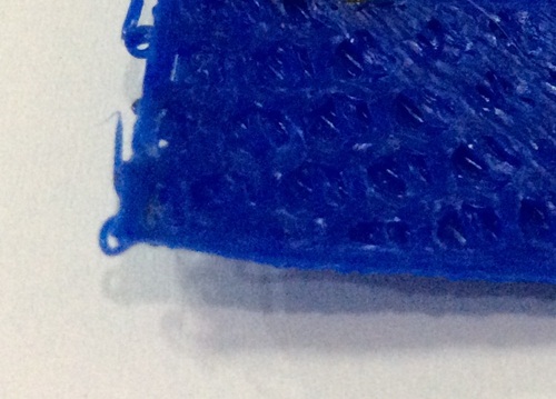

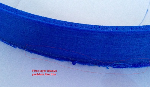

2. I test many file some of them it occure on first layer
The problem is first layer not attach with hot bed in some area ( especially on the corner )
so on the next layer will make bad print . How i fix this ?

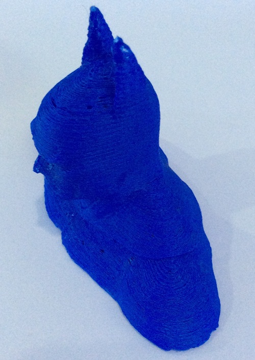

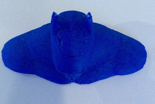

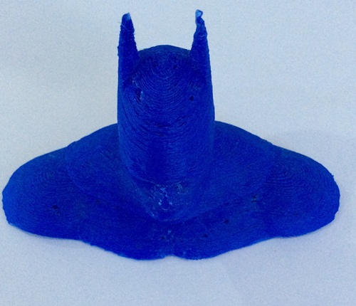

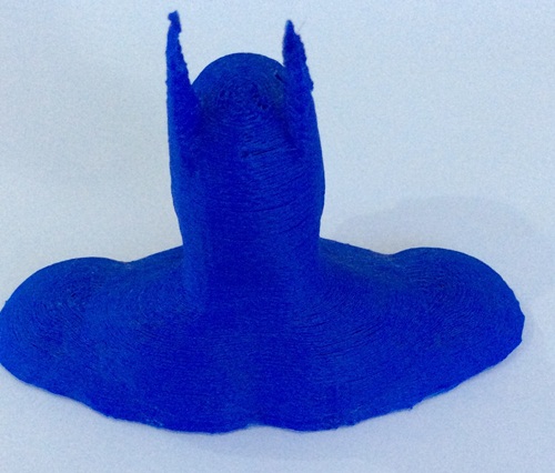

Hi All
I just test Batman as image I attached
You will see some big pitting , hole
How can i improve this surface to better ?
Why this occure ?
Thank in advance

Re: Pitting , Hole , Defect on printing
Decrease the layer height (except first layer), there will be less holes or even no hole.
As for the sharp part: When printing the sharp part, you should lower the printing speed.
But when printing the top, it can't print perfectly because its area is too small that the nozzle melt the printed part.

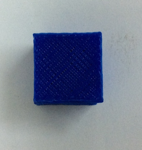

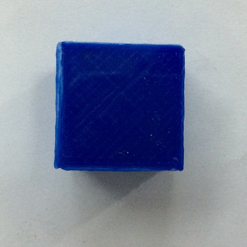

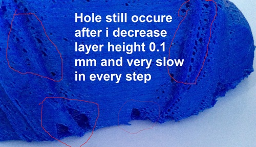

Hi
I just many test
I still have problem of hole
1. Like this picture
2. For first layer and 2,3,4,... It is not smoth , and many problem like this Could you suggest me ?
Thank you
Theo
I just many test
How about other parameters of slicer settings? Could you please give me some screenshots.

zhangxueyou
- Posts: 1405
Fill density is too high, lower it to 25%.
Extruder width of first layer is all too high, lower it to 200%.
Please tell me Estep displayed on LCD . (Control>Motion>Esteps/mm)
