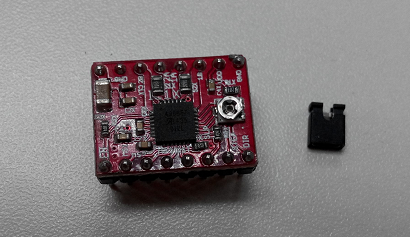

Post by zhangxueyou »
On the left side is motor driver(A4988), right side is jumper cap. It should be plugged under motor driver.
A4988-jumper cap.png (135.05 KiB) Viewed 12441 times
