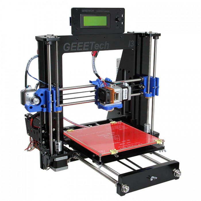

Mine is starting to sag too, I noticed some splitting when installing, but it's getting worse, see image:
I'm printing a new one now, but the one pictured below one looks to have more support. I would really appreciate it if you could send me the better one, or provide the .stl file.

Hi, the extruder you have is the improved one, but I think it was printed in PLA, ABS is better.mvdarend wrote:Mine is starting to sag too, I noticed some splitting when installing, but it's getting worse, see image:

OK, thanks. I'm printing it now, almost finished
