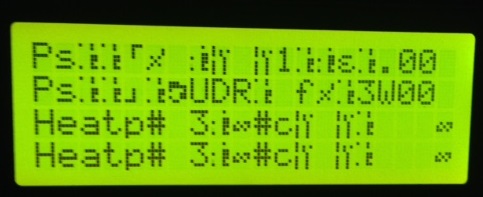

Printer Acrylic Prusia I3 with Sanguinololu.
This does not happen on a regular basis.
When I reconnect the LCD board it show correct characters (except special symbols).
Once the control board hung.
LCD garbage
LCD garbage

Please make sure the wires are well connected. Turn off the printer, and turn it on again.

I have checked cables many times.
After restart the printer works fine for a some time.
But what can I do while printing? If I restart print I lose printed model.
May be is it the firmware or COM port setupt issue? I set COM port to 250000.
How to check the firmware version I dont know.

I have checked the firmware version: 1.0.0, compiled: Feb 2, 2015 15:17:04.

How about printing without computer? I mean print offline with SD card.

Garbage characters do not appear a few days.
A new problem have appeared.
The computer often lost connection with the printer.
Often during the beginning of the second printing.
I reconnect USB and print successfully.

I have replaced USB cable. Now works fine.
