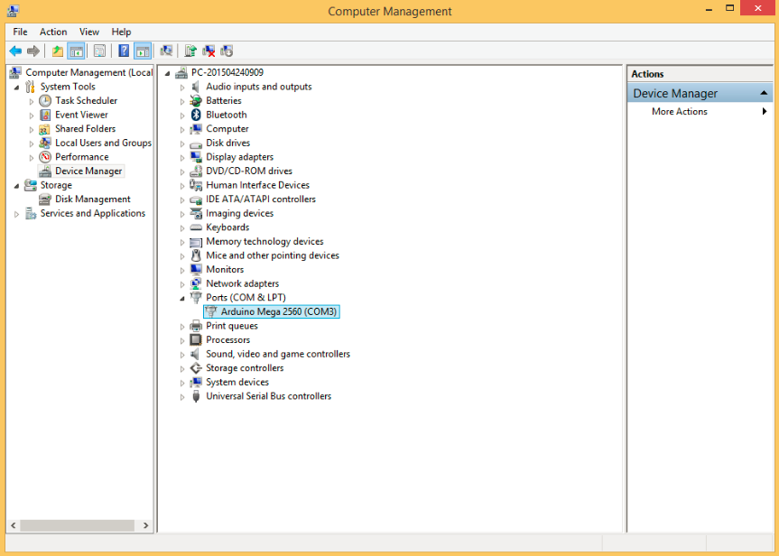

Before connecting , make sure the driver of Arduino Mega 2560 is installed, if your mainboard type is Ramps1.4+Mega2560.
If your system is Windows 8.1, make sure you have installed your printer correctly.

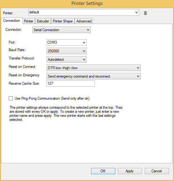

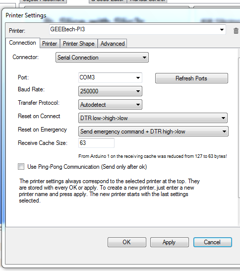

1. When you connect your printer to Repetier, you may see the dialogue as the picture below, so please check the Com port in Device Manager: 2. Choose correct Baud rate (250000): Then you can control your printer in Repetier-Host.
If you can not move the axes, you should let them auto home first.

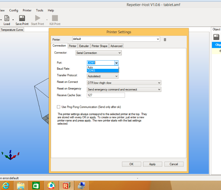

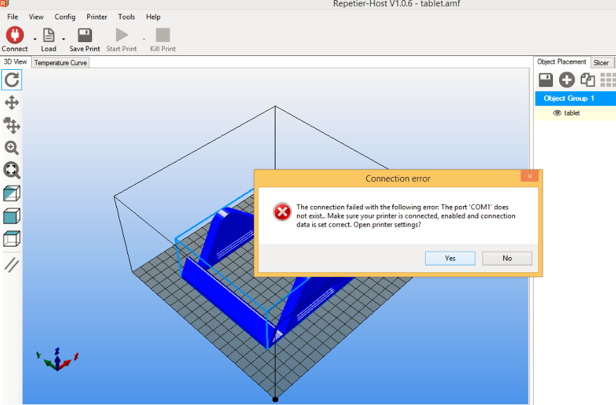

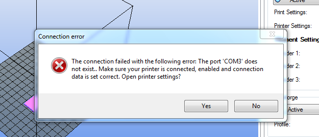

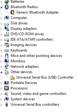

I currently try to connect to Repitier and it tells me COM3 does not exist. As previously mentioned i have had this connected in the past and was on my way to setting up for my first print.
I also look in the device manager and it tells me that this is an Unknown Device.
I am not sure what i can try to resolve such issue, I tried to reinstall the driver but also got errors.

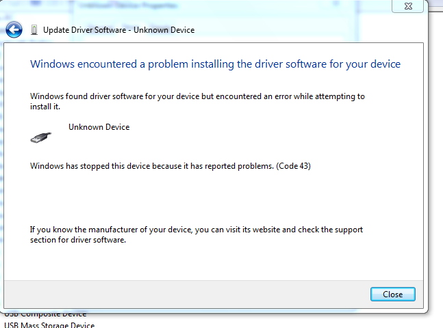

I retried to install the driver and did have success, and whilst i was making progress i thought to continue to try and upload the firmware, but it was 3/4 way through that and came up with an error, should be the first picture attached.
i decided that i would restart my computer, and after i did that i got the USB not recognised message again, along with the device manager error as aforementioned.
Are you able to indicate why these issues are intermitent (one minute its working and then the next and its not)
As mentioned i had all this previously hooked and everything was communicating fine as it should and now one thing is leading to another and i seem to be going around in circles with not a whole lot of progression, any suggestion is greatly apppreciated

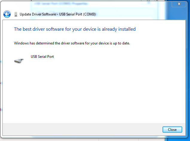

some more pictures
In my device manager it shows some yellow triangle (issue)
I tried to reinstall the driver a number of times and it goes through the installation process fine (so it appears)
but still has this error
In the arduino software under tools , the serial port option is greyed out ( i am unable to click on it) . IN the past it has show COM3 and work fine.
Hopefully some of the screenshots show some of my issues, but what is troubling me is that i dont seem to have the same problem twice, fi something and then something else seems to be messed up in the process,
Thanks

Re: How to connect your printer to Repetier Host
have you tried the link I said before? update it manually.
And download the driver here:http://www.geeetech.com/wiki/index.php/ ... he_drivers
If this not gonna work, then I think the board might be defective.
