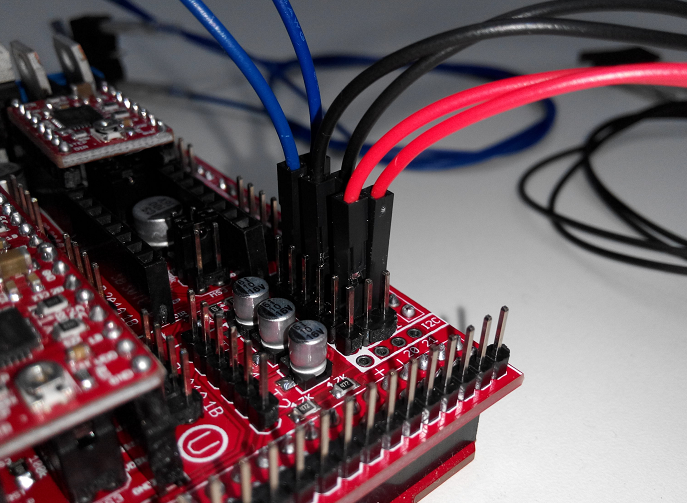

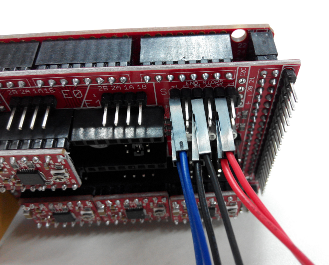

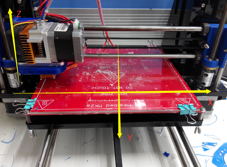

Good morning,
First confusion. Left to right should be X Y Z?
blue wire x extruder assy
Red wire Y plate assy
Black Z vertical axis
PDF for ramps is wrong pic btw shows connector side to side
I have firmware for i3b I found here working. Trying to adjust extruder height and speed now.

3D printer is a DIY product. Not all the firmwares are the same. We have our own settings according to our design. So the firmware you download from internet is not necessarily exactly correct.joellog wrote:Good morning,
When using repeater there were no EEPROM setting showing so I wanted configuration file.
Ramps on site doesn't seem to be configured for display.
Please email me firmware to joellog@aol.com for comparison.
Thank You for your help
Please check your email.

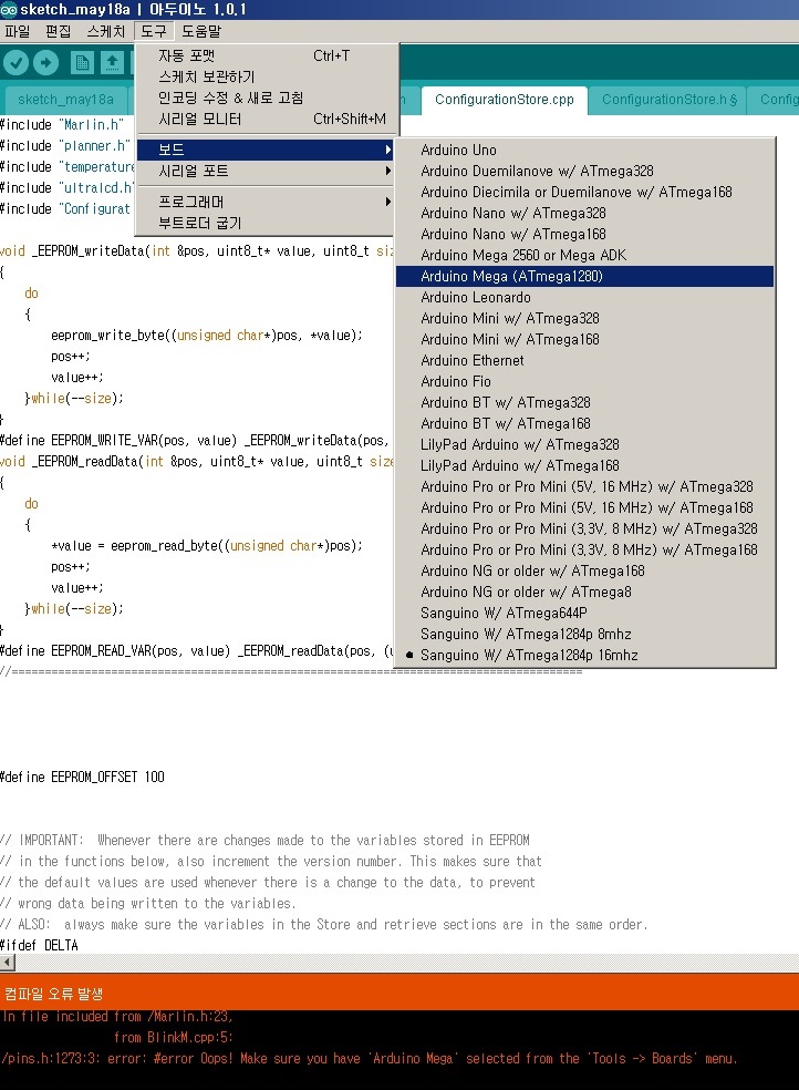

Hi
I've done all the steps as you posted but struggling with compiling the files in arduino. I've selected the board type as Arduino ATmega 1284p but it keeps coming up with an error that tells to select Arduno Mega for the board type and it actually compiles if i change the board type to Arduino Mega(my controller is ATmega 1284p). So i was wondering if you could help me solving this problem please.

Are you sure your mainboard type is Sanguinololu?Bright Idea wrote:Hi

Re: How to upload the firmware
Is it not?
Did you lose some files when dragging the file into arduino? 59 files in all.Bright Idea wrote:Is it not?

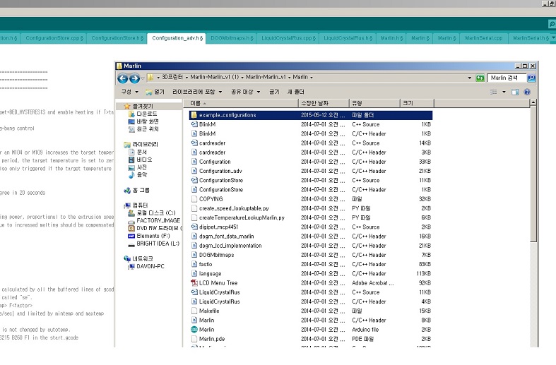

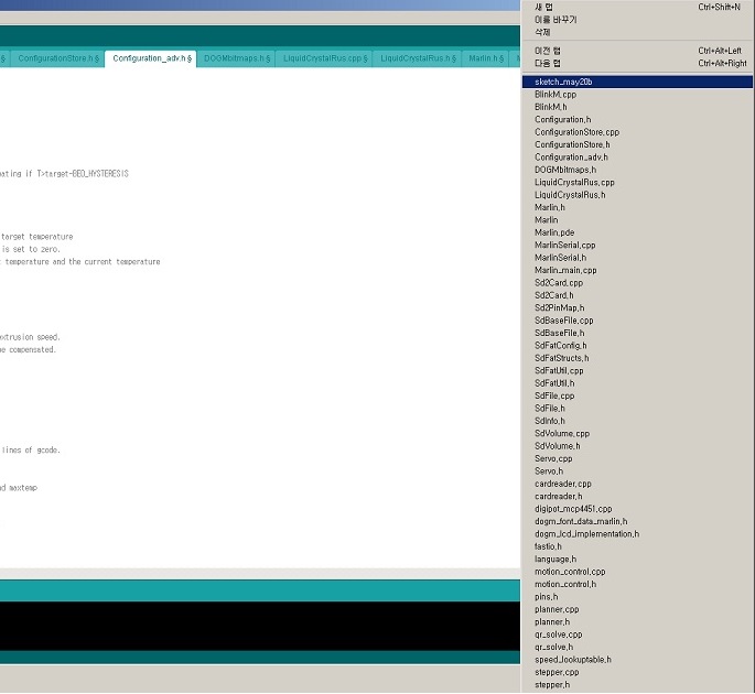

Bright Idea
- Posts: 4
- Joined: Sun May 10, 2015 12:25 am
A message saying "example_configurations cannot be added to the sketch" pops up as I drag the whole files into arduino. Except the code files in "example_configurations" folder which are four, I have 57 cpp and header files only under Marlin folder and I'm not sure if all the files are correctly loaded because arduino only displays 48 files maximum.
