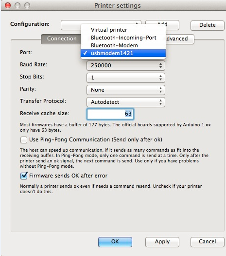

If you want to control the printer on mac, you should intall Repetier for mac first:
http://www.repetier.com/download-now/
Open Repetier-Host, choose correct port and Baud rate(250000) in "Pinter>Printer settings".
If you are not sure which port is correct, unplug the USB cable, then plug it again, the new port name in option of "Port" is the one.

Thank you. I got it running with my mac. This tutorial helped me.
