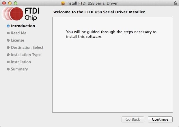

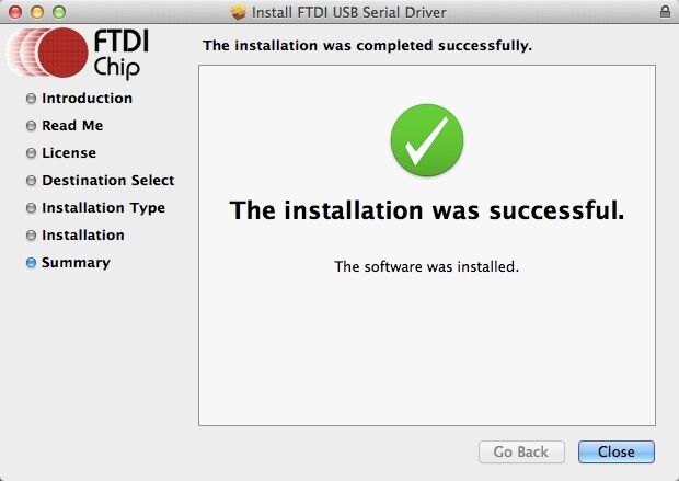

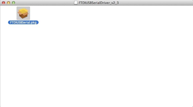

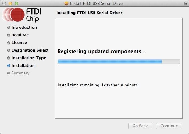

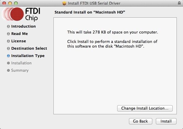

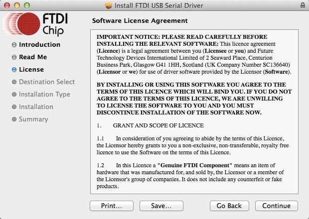

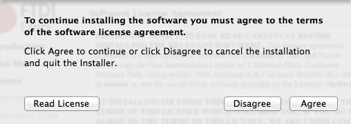

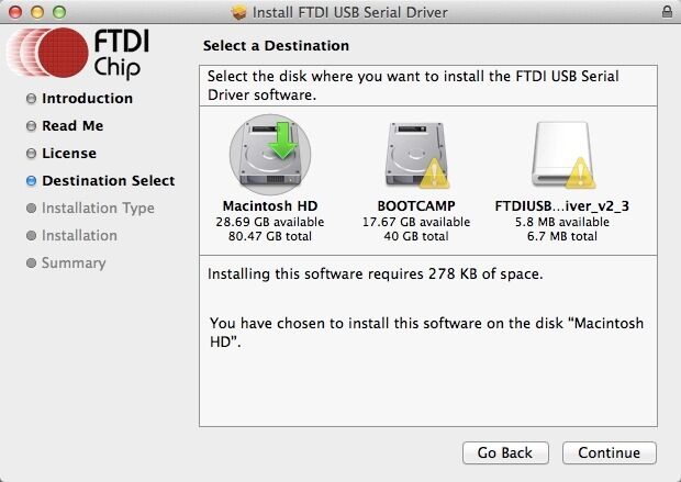

1. Install the Driver (FTDI USB Serial Driver)
Download link:http://www.ftdichip.com/Drivers/VCP.htm

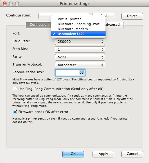

Open Repetier-Host, choose correct port and Baud rate(115200) in "Pinter>Printer settings".
Note: the baud rate, usually it is 115200 for the Mac, so you need to make sure the baud rate in the firmware is the same value too:
// This determines the communication speed of the printer
#define BAUDRATE 115200
And if that's not gonna work, you can try 250000 and other values, just make sure the value in printer settings and firmware are the same!
If you are not sure which port is correct, unplug the USB cable, then plug it again, the new port name in option of "Port" is the one.
