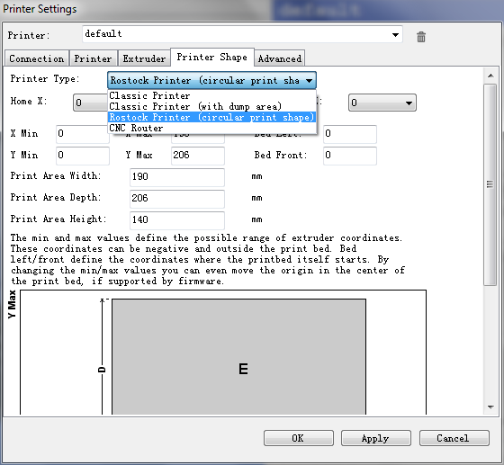

2. You should let all the axis first, and you should choose correct shape of printer:
