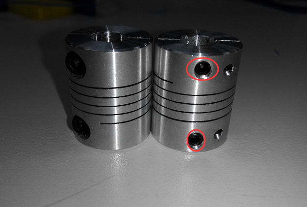

My rod diameter is about 7.8mm, and coupling is 8 mm. They fit each other if I tighten the screws.
There are 4 screws in coupling, 2 for narrow the hole, the central 2 for tighen rod and motor shaft. The srew should face to the level side of shaft.

My coupler only got 2 screws there are no small screw hole for grub screw to lock the threaded rod nor the motor shaft on the coupler. Picture attached below for proof that no grub screw holes

Look, there are still 2 screws in coupling:

zhangxueyou wrote:Look, there are still 2 screws in coupling:
Here is the thing that i rotate to let you see if there is any extra 2 screws to clamp down the rods or not
