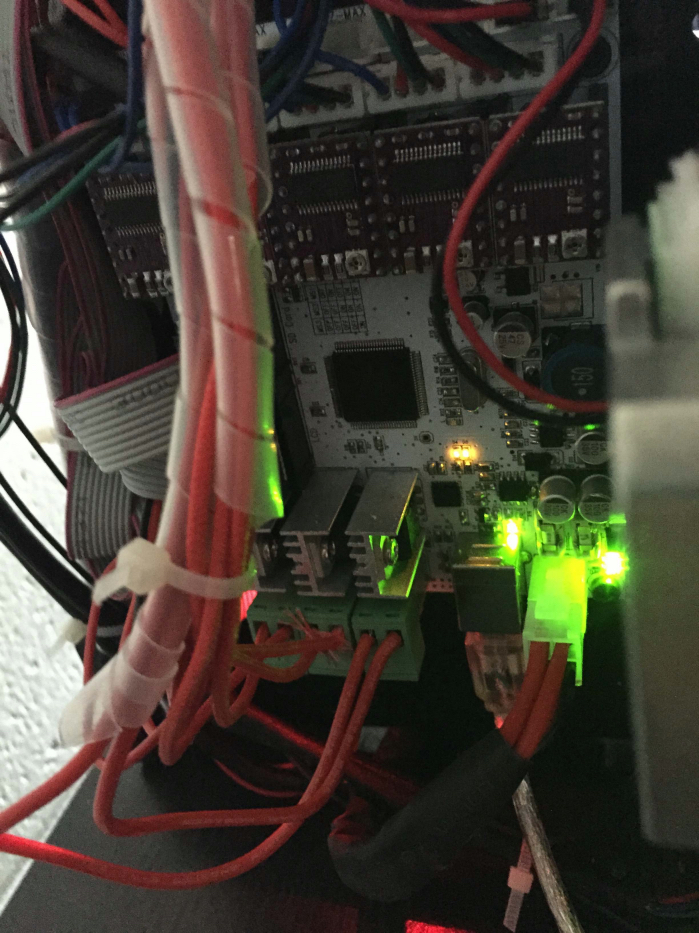

Only when you plugged the fan wire reversedly, will the fan be dead. How did you connect the fan? Leave a picture, let me check.

How do you connect the enstops? Are they connected to "MIN" slots?

Yes the baud rate is 250000. here is the photo of the wires connected into the min slots. I cannot move the extruder or x. It says 1 command waiting and will not move

Before you swapped x motor drivers with extruder motor driver, you could move extruder. It seem the x driver is bad.
But I am not sure completely. What is the version of Repetier? Is it 1.0.6?
