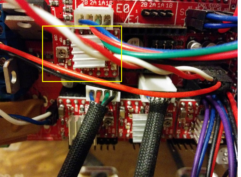

Hello Sorry for not getting back with you in a while I have been rather busy with other items. I have taken several pictures of the main board wireing but it is a bit hard to see everything. I hope these help.

You connect the extruder motor in wrong direction, so the extruder motor can not move.
You are the lucky one. Worstly, connecting motor driver will destroy the driver, even the whole mainboard.
And the blue part on board must be near to cooling fan, when heating the be, the temperature of MOSFET will be very high.
You can print a fan mount to change the position of extruder, the stl file is at this page:
http://www.geeetech.com/forum/viewtopic ... 24&t=16304
