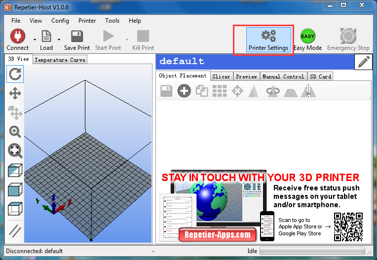

Open Repetier-Host (Download link: http://www.repetier.com/download-now/), Access "Printer settings":

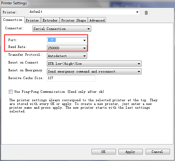

Set correct baud rate and serial port:
choose baud rate and serial port.png (23.6 KiB) Viewed 66088 times

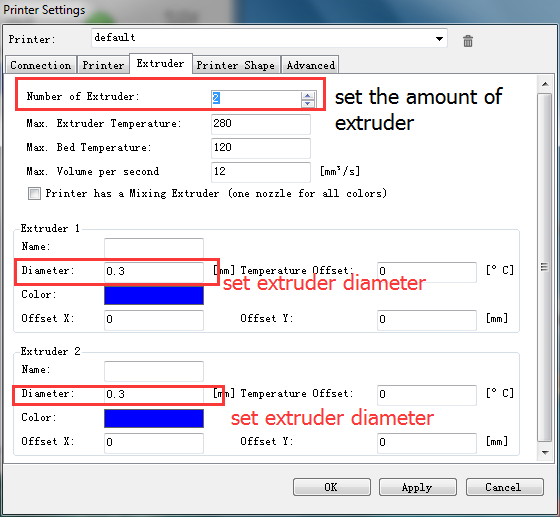

Set amount of extruder as 2, and set correct nozzle diameter:

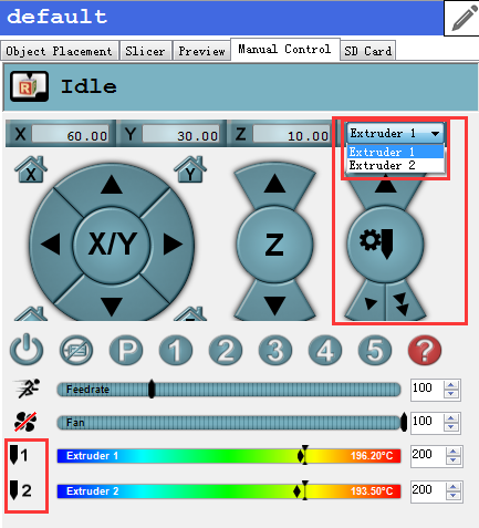

Then you can control both extruders on Repetier-Host (Note:The extruder can not move unless the temperature is more than 180 degrees):

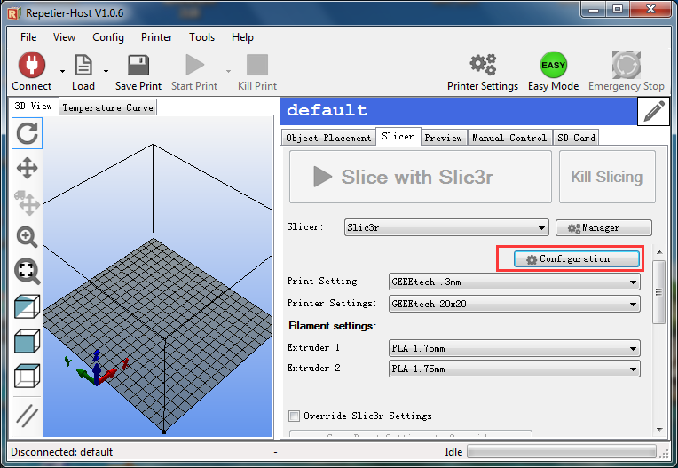

Slicer setting:
To have a good 3D item,you need to have a good slicer setting, and distribute jobs for 2 extruders:
Click "configuration" to access slicer setting:
For more details of sclicer setting, you can download the attachment to refer:
slicer settings for I3C.zip
