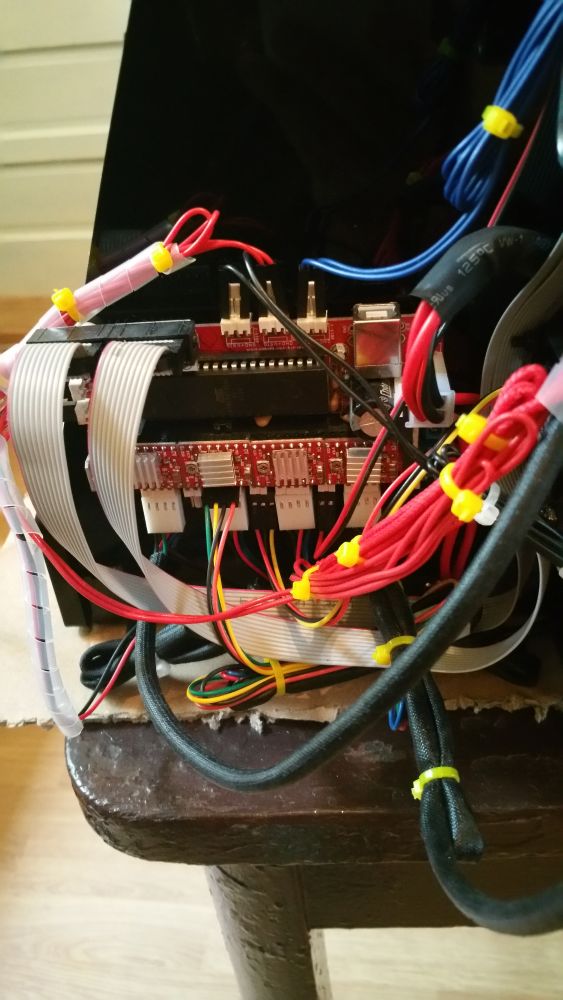

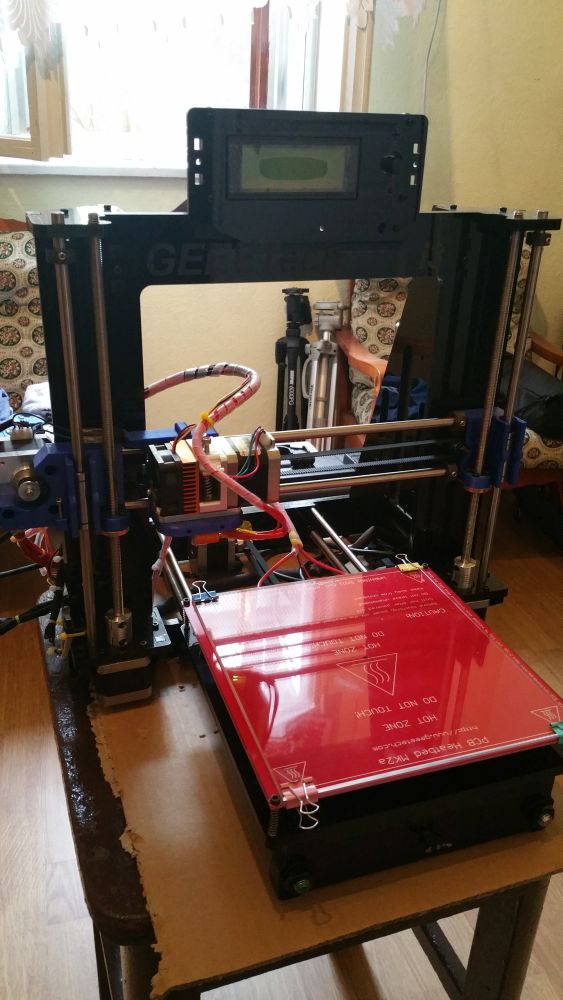

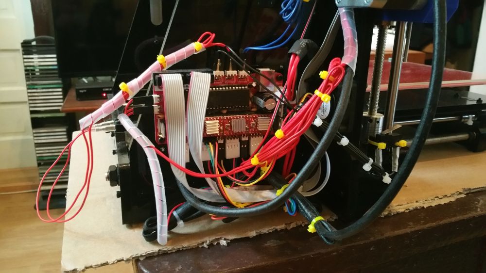

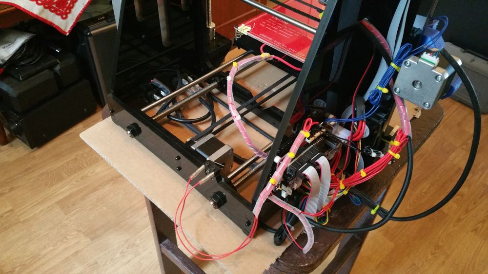

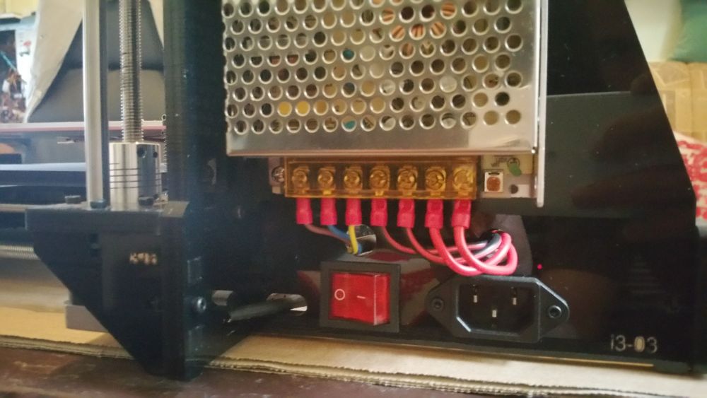

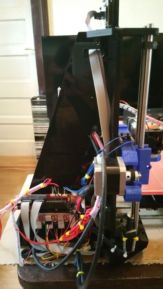

Could you please take some pictures of printer in different angles? Including front side, left side, back side.
And please take a picture of mainboard with wiring, I want to check if every endstop is in correct position.a
Re: Y axis stepper motor issue
Here are the photos. Please let me know if you need any more. Thanks!
- 20150630_175956.jpg (101.6 KiB) Viewed 14640 times
- 20150630_180213.jpg (86.5 KiB) Viewed 14640 times
- 20150630_180130.jpg (73.35 KiB) Viewed 14640 times
- 20150630_180107.jpg (122.57 KiB) Viewed 14640 times
- 20150630_180057.jpg (78.84 KiB) Viewed 14640 times
- 20150630_180036.jpg (94.81 KiB) Viewed 14640 times
