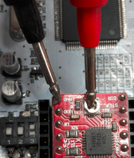

3) Raise the power of extruder motor: There is a screw on motor driver, rotate the motor driver slightly to raise the voltage between screw and GND to 0.9-1V.
test referring voltage.png (438.77 KiB) Viewed 39853 times

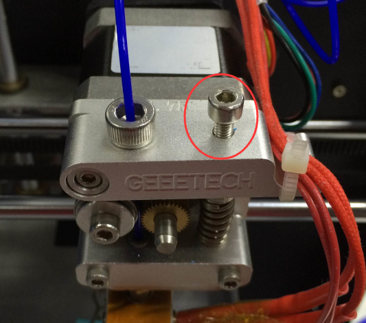

Also how far to screw the tensioning spring screw on the top into the frame/spring, and how far into the bottom of spring to insert the Spring Stop Screw.
