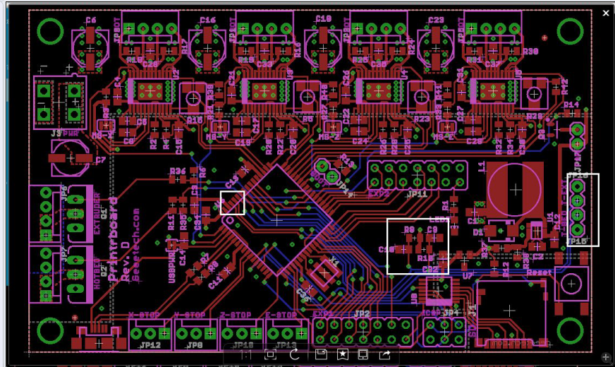

hi,vbsargent.maybe the some parts of rev D is short circuit.look at the picture,you could check these place marked by white frame with multimeter.by the way,please tell me the temperature of LCD shows.if i could not deal with the issue,i will help you contact the saleman as soon as possible.thx

I will try checking with a mulitmeter this evening. As I stated I do not have LCDs with my printers, but Repetier Host registers no temperature readings with the new board. Looking at the diagram provided, I'm not even sure where to put the positive and negative probes of the multimeter to test the processor (small square on the left near C15) or the large center square containing R8 and C9.
