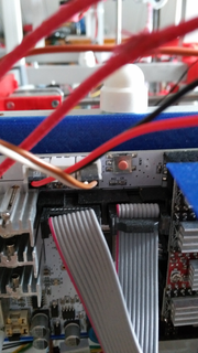

The opening of the connector (LCD / SD Card) must be below. See the red marks. Is how it works with the standard LCD cables (RAMPS).
Sherry
Posts: 362
Re: 2 problem's with GT2560: LCD2004; 24V
Post by Sherry »
Roe-3D wrote:The opening of the connector (LCD / SD Card) must be below. See the red marks. Is how it works with the standard LCD cables (RAMPS).
yeah,it is.EXP1 connect to LCD,EXP2 connect to SD
Roe-3D
Posts: 6
Joined: Sun Jul 19, 2015 4:35 am
Post by Roe-3D »
This is how the connectors should be placed. Have a look on the red side of the cables.
futurefear
Joined: Thu Jul 12, 2018 10:23 am
Post by futurefear »
Hey THANKS SO MUCH, Had the connectors backwards because the opening on the replacement GT2560 board i ordered had them placed backwards just like shown, That and a bunch of troubleshooting the baud rate of the marlin firmware needing to be adjusted down to work in repiter-host before uploading and i am back in business!!!
