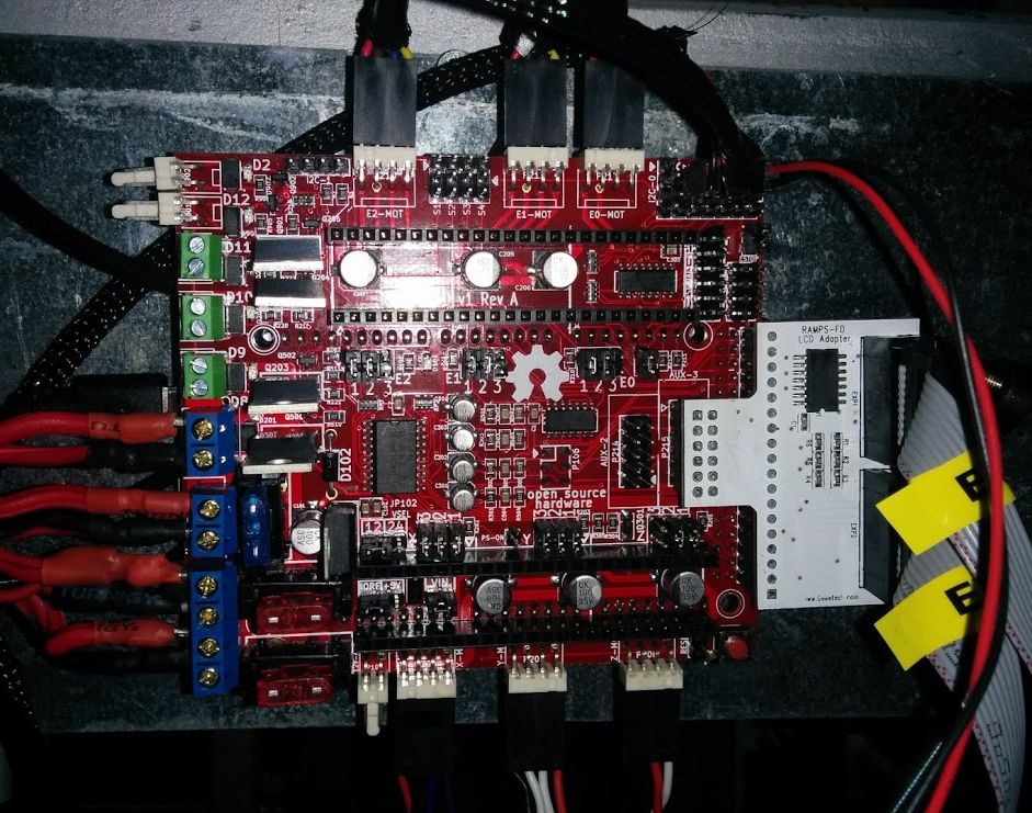

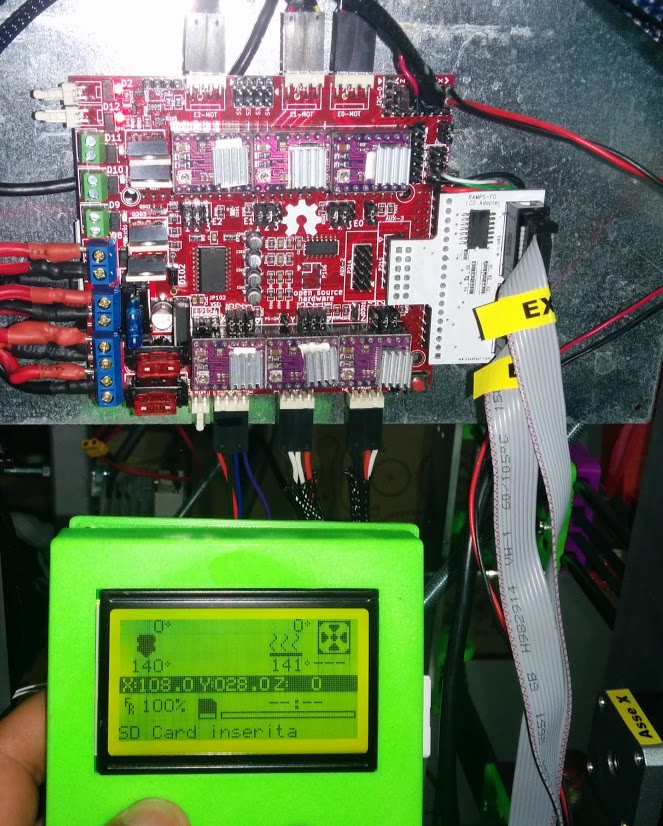

Good Evening
I have no movement of motors and read the wrong temperature
Use Ramps FD V1a Arduino TWO and Drivers 8825
I verificarer if the Jumpers and the drivers are installed correctly
Place two photos.
Thank You
In Ialiano
Buona Sera
Non ho movimento di motori e leggo temperatura sbagliata
Uso Ramps FD V1a Arduino DUE e Drivers 8825
Mi verificarer se i Jumper e i drivers sono montati in modo corretto
Posto due foto.
Grazie

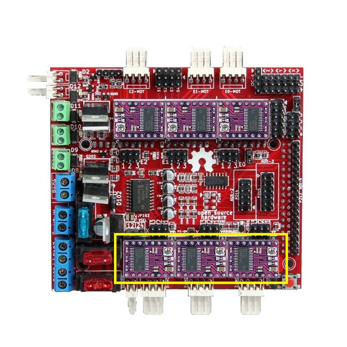

Hi,saviothecnic .According to your pic ,I think 3 of your drivers were wrong installed, they should be like this:

Ok Thanks indeed there tava an arrow pointing to Enable and I have noticed :(
Now unfortunately shot two DRV 8225 were burned but otherwise everything OK
Now I have another problem on temperature probes They read semrpe always up 140 ° C
