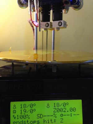

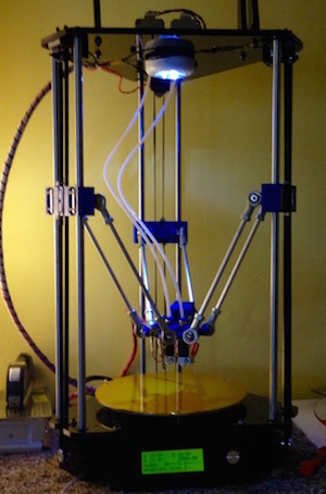

No Mark, the printer cannot be reliably controlled manually, so I have been having problems trying to calibrate it. For example, I did the following:
1. Pushed the extruders to the top position and activated the end-stops
2. Turned off the printer and then turned it on again
3. Disconnected and reconnected to the printer with repetier
4. Entered the following command: G0 X0 Y50 X2 <Send>
5. The extruders moved to about the following position 52mm from the hotbed (Z) and offset about 50mm from the centre of the printer (I assume Y)
6. I select Z -10 and the printer tries to move and stops saying that (endstops hit: Z)
That means that the wiring is incorrect and that for some reason it thinks I hit the Z endstop which I haven't reached, refer to the photos below
- endstop_Z_hit.jpg (49.92 KiB) Viewed 13690 times
- no_endstop.jpg (49.46 KiB) Viewed 13690 times
