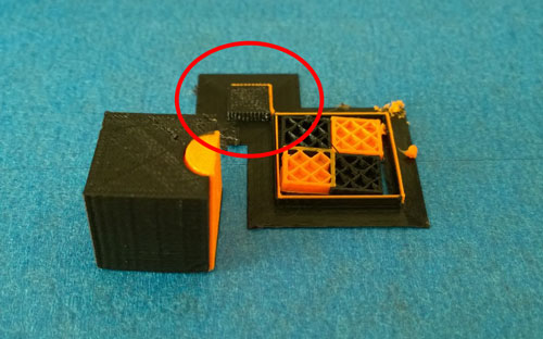

Hello
Here's a picture attached showing the slight misalignment. It's most visible in the wipe tower highlighted in red.
X axis has about 0.7mm and Y axis about 0.5mm I don't remember the exact measurements right now.
And it seems that setting extruder offsets either in Cura or Repetetier won't have any effect so I was wondering if the fine tuning is supposed to be done in printer firmware file?
thank you in advance for your answers! :)

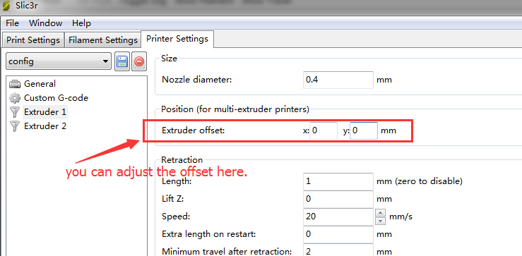

How about adjust the offset here.

I have done this.... but mine still prints two completely different parts.
There is no change...
is there a more practical way to go about this.....???
