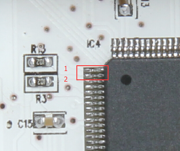

According to what you said, it might be a short out between the hotbed printed circuit and the USB circut.
You can do this to verify it:
1) set the hotbed to a very low temperature, and start printing to see if it happens again;
2) use a multimeter to check this two pins( 1and 2 of the chip) if they were shoted or not.

- QQ截图20150826172553.jpg (310.03 KiB) Viewed 9909 times
Re: USB connection Lost when heaters are on Heatbed or Extr
Thank you for your reply, those 2 pins are short, As soon as the bed is heated even at low temperature like 32 I get Serial com error. What is the next step ??

As mentioned those 2 pins are shorted. The connection lost happens when the bed is heated even at low temperature.

1) Use the soldering iron to resolder these two pins and make them separate;
2) If it's hard to resolder it, use a knife to cut the soldering apart; but be careful with the board.
