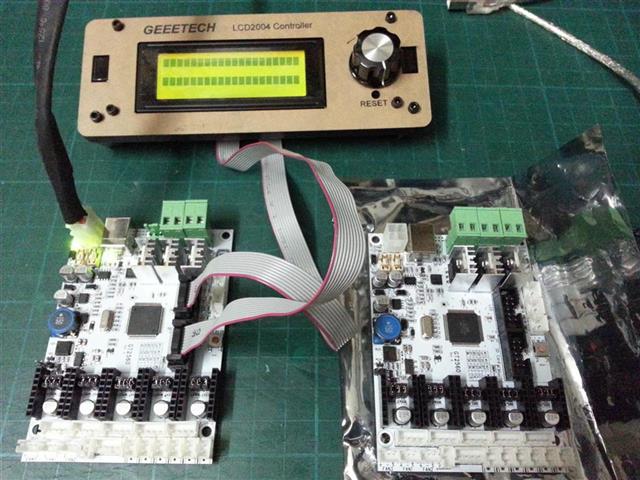

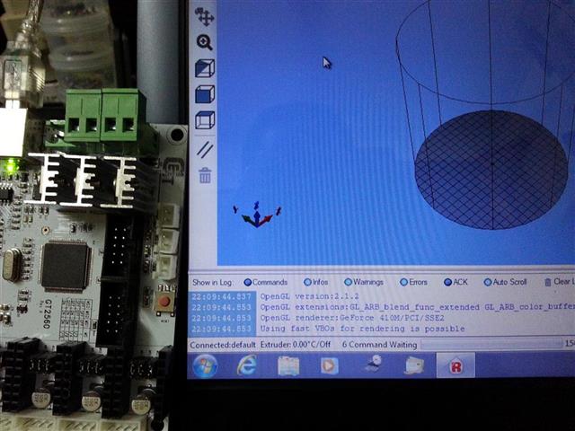

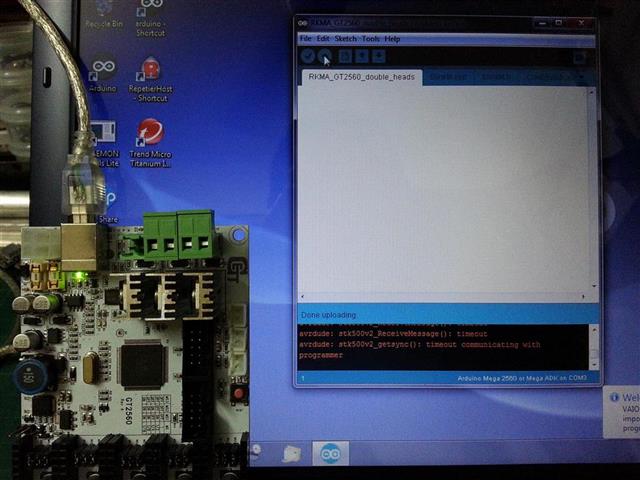

After putting everything carefully together (and constantly checking all the online exchange in Geeetech Forum) I powered up the printer but I get are 2 lines of blocks on the LCD display. I can connect from Repetier Host but it keeps getting stuck in Command Waiting. I tried everything mentioned in the forum from re-installing the FTDI driver and re-burning the GT2560 firmware. When I re-burn the firmware, I got AVRDUDE errors with both Arduino ADE 1.0.1 or ADE 1.0.5. Both Command Waiting and AVRDUDE errors seem to indicate the GT2560 board is not communicating properly. It uses COM3. I am not sure what that is but I decided to order another GT2560 board from Aliexpress. I have to wait for 4 weeks before it arrived. It worked straightway with the LCD screen display the controller menu correctly. This board uses COM4 and I can successfully upload the firmware. I can also successfully control the printer through the manual commands in Repetier Host. I have attached the photographs to show you the difference between the 2 controller boards.

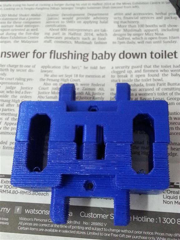

I doubt my superglued plastic parts will hold so I am requesting Geeetech to send me the following replacement items. I have waited till now and I hope I do not get disappointed.
A. A full set of plastic printed parts. Please ensure all the 3 carriage parts are identical.Two of them have difficulties installing onto linear bearings.

- Stock GT2560 - showing avrdude errors when uploading firmware
- Stock GT2560 - hit avrdude error when uploading firmware.jpg (50.39 KiB) Viewed 12633 times
- Stock GT2560 - Command waiting in Repetier Host
- Stock GT2560 - Keeps showing Command waiting in Repetier Host.jpg (54.14 KiB) Viewed 12633 times
- Stock GT2560 - LCD showing blocks
- Stock GT2560 not working - LCD showing blocks.jpg (70.59 KiB) Viewed 12633 times

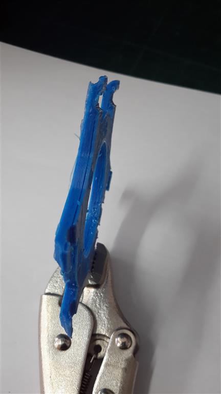

- Re-print of platform with ABS at 210C - part lifted off the bed
- 2nd print - ABS at 210C with delamination and part lift from bed (Medium).jpg (24.2 KiB) Viewed 12633 times

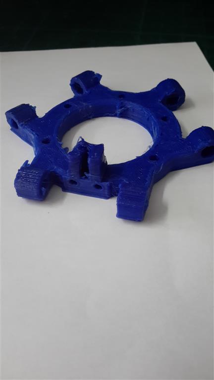

- Printed platform with PLA - poor quality
- 1st print - hotend platform printed with Geeectech PLA (Medium).jpg (20.73 KiB) Viewed 12633 times

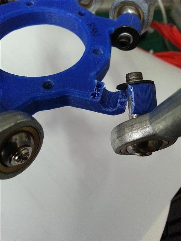

- Platform broke at rod mounting point - hollow and not solid
- Carriage rod mount broke at another place (Large) (Medium).jpg (49.4 KiB) Viewed 12633 times
- All 3 carriage dimensions at the linear bearings areas are not identical
- All 3 carriage parts are not equal (Large) (Medium).jpg (78.64 KiB) Viewed 12633 times
