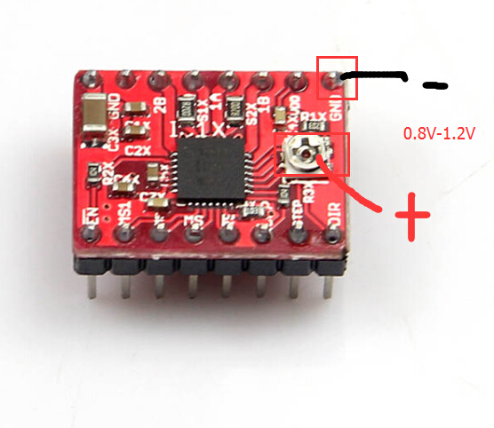

1) what is the voltage of the 8825? measure the voltage of the potentiometer when powered with USB. you can compare it to 4988 to see the different .

I tried measuring the voltage reference, from the +5v point to the left of the atmega chip and the pot screw, it shows me a constant 5.0xxV even I tried to turn it on the drv8825, on my spare a4988, it shows roughly about 3.7xxV, I moved the probe to the main power input and the volt on drv8825 shows about 0v, while the a4988 shows around mv or 1.3v max. When turning it in clockwise, it somewhat resets itself again to mv values

And the voltage should be measured like this:
1. If it shows "358/0, room temp/0; Err: MAXTEMP". The extruder thermistor is short.
2. If it shows "358/0, 358/0; Err: MAXTEMP". Both extruder thermistor and hot bed thermistor are short.
3. If it shows "room temp/0, 358/0; Err:MAXTEMP BED". The hot bed thermistor is short.
Please check if somewhere of the wire are connected. If so, the current will not go through thermistor, and LCD will diaplay TEMP ERROR ."
- driver voltage.jpg (195.4 KiB) Viewed 16681 times

Also in accordance to voltage measurement from pot and gnd pin for stepstick, I get 0v on my drv8825, not tested on a4988 yet
