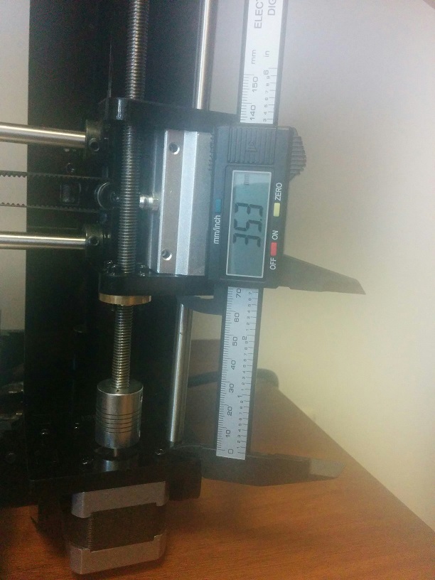

Make sure with a caliber that both sides of Z axis are at the same height. This can be done by measuring the distance between the two acrylic plates as demonstrated in the photo below. If they are not level, there will be more resistance to their movement. Rotate the coupler in one side by hand to lift or lower that side.

measure z axis.jpg (124.67 KiB) Viewed 65573 times

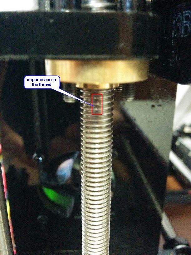

Looking carefully at one threaded rod I have noticed that at that location, there is an imperfection at the thread of the threaded rod. This imperfection caused a slightly higher resistance when that imperfection was inside the Z axis nut.
z threaded rod imperfection
z threaded rod imperfection.jpg (78.81 KiB) Viewed 65573 times
This was solved by applying lubricant (WD 40) to the rods at the imperfection location and above and below it, and then rotating the couplers by hand back and forth several times in order to move the imperfection several times through the Z axis nut. After moving the imperfection through the Z axis nut by hand, I started to move the imperfection through the Z axis nut from the software. After about 20 such movements, the Z axis begun to reliably move through the imperfect point.
There were several such imperfect points at different heights of Z axis. Using the same method of lubricating and going through these weak spots back and forth several times solved the inability to move through these locations, and eventually the Z axis was reliably moving up and down the full 15 cm!
