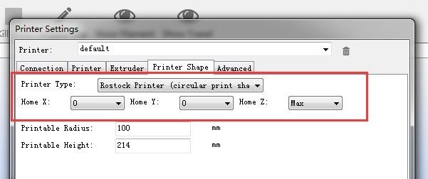

1) First check the endstop status. Do note that the endstops should be plugged in X Y Z MAX for G2/G2S, not MIN. And the probe should be connected to pin 1 and pin3(the first and the middle one). Since the printer can not home itself, you can manually trigger the endstop one by one(with probe up), and use M119 to check the endstop status. after homing, the status are like this:

2) manually move the axis one by one, check if all the axes going in the right direction as you told.
3)set the correct settings of your printer:
- QQ截图20150914212050.png (28.43 KiB) Viewed 13623 times
