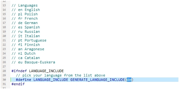

Can I change the language in some way or are there problems? I saw flags that show my tongue. If there were no conflicts would love to have it on display.

You can change the settings in language.h tab in the firmware, and re-install the firmware.

I do not know what it's called the flag indicating why you cut the screenshot at the top where I could see where change but I do not know how to reinstall the firmware
Re: arduino. First step... error!
You can find it in the tab language.h in your firmware. and refer to the link here to re-install the firmware:

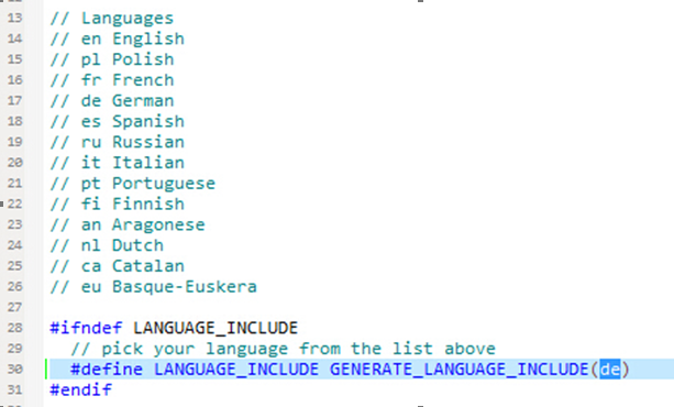

3.2.4 Choose the language, open ”language.h” in the firmware, find the following codes and choose the corresponding one for yourself.
(refer to picture 3)
