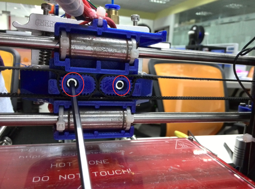

hello,
it's ok that i level one extruder one the printer bed but the second one is not the same hight as the first one.
i looked for solution and found one your site a picture that you have to losen some screws but the screw on the picture are the one who holds the motor carriage part tot the x-carriage part.
so that's not the solution is thing.
what can i doe?
thanks steven
Mark
Posts: 1553
Re: leveling the two extruders same hight
Post by Mark »
The way you said works indeed, because of the elasticity of the PLA carriage. But it just fit for those nozzles that the gap are very small.
You can refer to the link here to find the right way:
https://www.youtube.com/watch?v=XGpcueIfUn8
