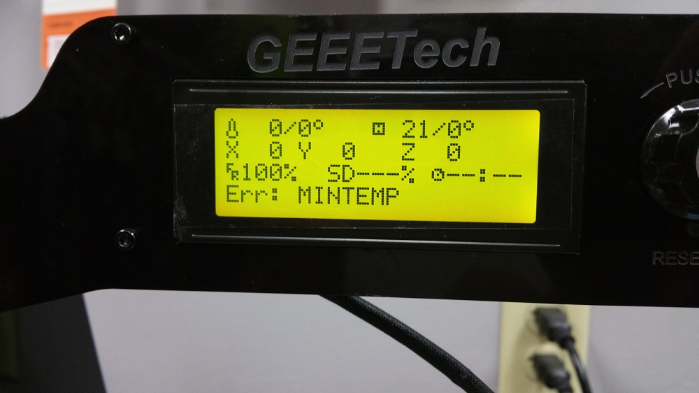

hi,the mintemp is caused by open circuit in somewhere.could you take a picture to let me see what lcd display.if that,i can tell which thermistor causing the mintemp.

hello im having same issue. this is my screen the bed was working now it isnt.

did you plug in the extruder thermistor in the right place?
