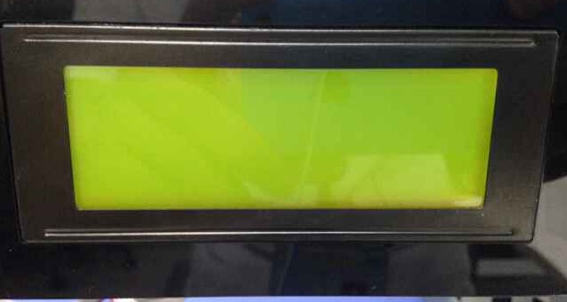

If the LCD only shows the backlight, blinking like every 2 seconds and no other information: Try to swap the LCD cable with the SD card cable. Make sure they are correct connected.

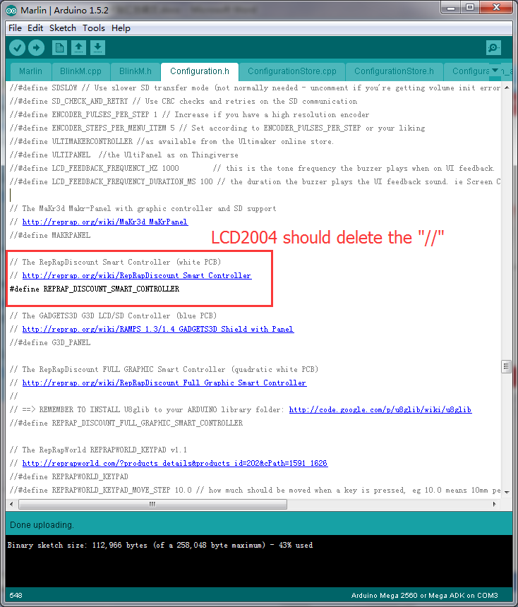

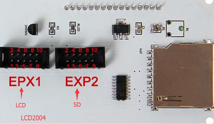

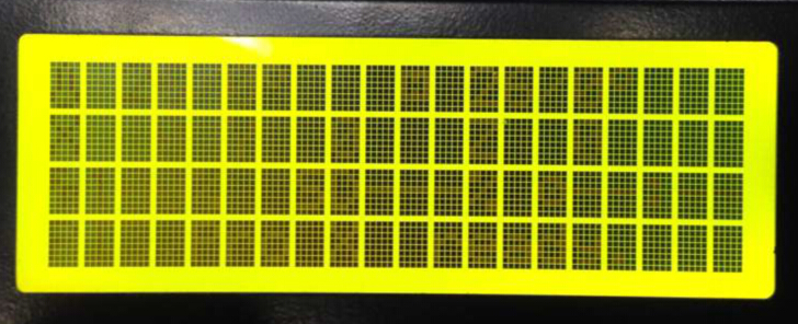

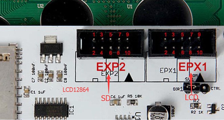

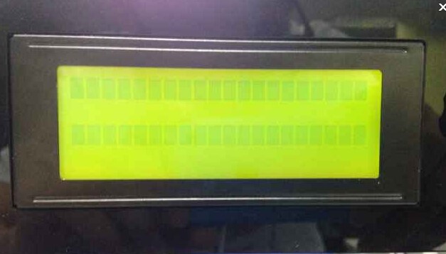

LCD2004: LCD12864: 3. LCD shows rectangles 3.1 For LCD2004, if you get the backlight and two rows of rectangles as the picture shows: First, check the wirings of the LCD and the SD card, sometimes wrongly connected it will behave like this.
Then if the wirings are correct, it might be the wrong settings of firmware.
For LCD2004 you should delete the “//” from this line of the code“//#define REPRAP_DISCOUNT_SMART_CONTROLLER”; And add “//” in front of the code” #define REPRAP_DISCOUNT_FULL_GRAPHIC_SMART_CONTROLLER”, because this line is for LCD12864. Then upload the firmware.
Before delete the “//”
// The RepRapDiscount Smart Controller (white PCB)
// http://reprap.org/wiki/RepRapDiscount_Smart_Controller
// The GADGETS3D G3D LCD/SD Controller (blue PCB)
// http://reprap.org/wiki/RAMPS_1.3/1.4_GA ... with_Panel
//#define G3D_PANEL
After delete the “//”, it should be like this:
//#define G3D_PANEL

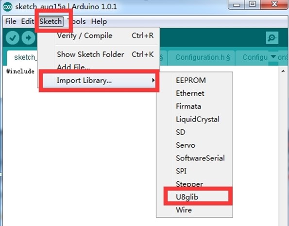

3.2.1 Check your arduino library folder, see if there is a library named U8glib. If not, download the marlin firmware and find the corresponding folder for your arduino version.
catalogue:\ArduinoAddons\Arduino_x.x.x\libraries
https://github.com/MarlinFirmware/Marlin 3.2.2 Restart your arduino and load the u8glib library:sketch>import library>u8glib 3.2.3 Reburn your firmware, and change the corresponding settings for LCD12864 in configuration.h tab.

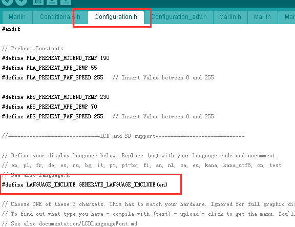

3.2.4 3.2.4 Choose the language, open ”configuration.h” in the firmware, find the following codes and choose the corresponding one for yourself:
// Define your display language below. Replace (en) with your language code and uncomment.
// en, pl, fr, de, es, ru, bg, it, pt, pt-br, fi, an, nl, ca, eu, kana, kana_utf8, cn, test
// See also language.h
#define LANGUAGE_INCLUDE GENERATE_LANGUAGE_INCLUDE(en) Hope this will heip you, thanks!

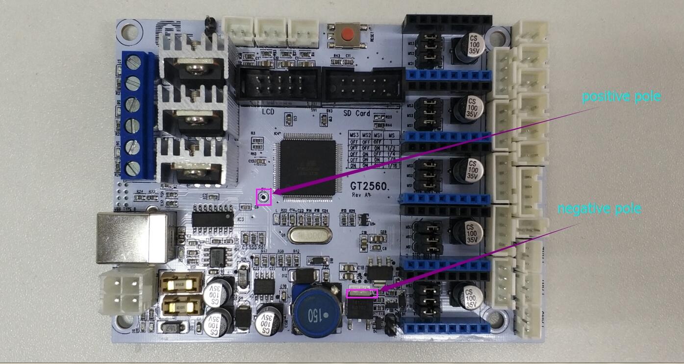

First i think you can measure the DC output of the PSU to see if it is normal(including connecting to and unplugging from the mainboard).
Then you can check if some other parts on the board are normal by referring to this post:

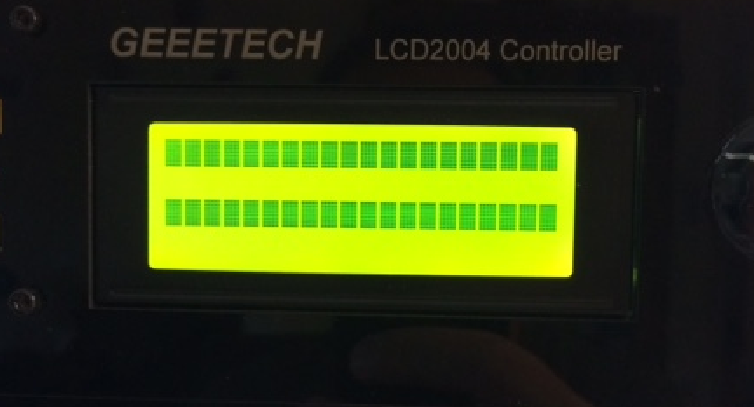

I have this problem, wiring is OK, Firmware is set to above settings, but still i cant see other than two rows of rectangles....
Geeetechs rAMBO 1.2g mobo, 2004 lcd panel (white rectangle pcb), tried with latest stable Marlin-1.0.2-2 and latest beta Marlin-1.1.0-RC8....
Been pulling my hair about this issue! Tried with so many different setups on FW but nothing seems to work
