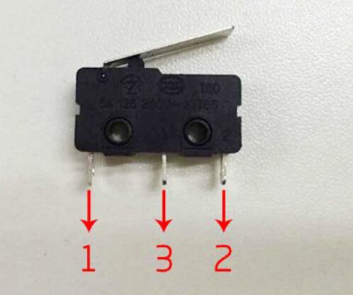

1. First check the endstop status. Do note that the endstops should be plugged in X Y Z MAX for G2/G2S, not MIN. And the probe endstop, if you use the old firmwrare for plastic G2/G2S, it should be connected to pin1 and pin3; and the new firmware for metal G2 pro/G2S pro, it should be connected to pin1 and pin2 , the same with X Y Zendstops. You can download the firmware here: http://www.geeetech.com/forum/viewtopic ... 10&t=17046).

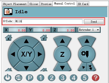

Homing the printer first, and use M119 to check the endstop status (with probe up). If the printer can not home itself, you can manually trigger the endstop one by one.
After homing, the status are like this:
X max: triggered
Y max: triggered
Z min: triggered
Z max: triggered
And when you put the nozzle down(with the probe down), like X0,Y0,Z=50, the endstop is as follows:
X max: open
Y max: open
Z min: open
Z max: open
If so, then the endstop status are correct.

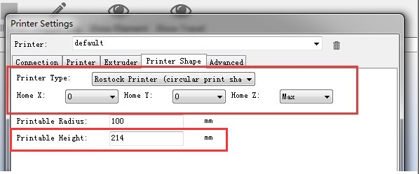

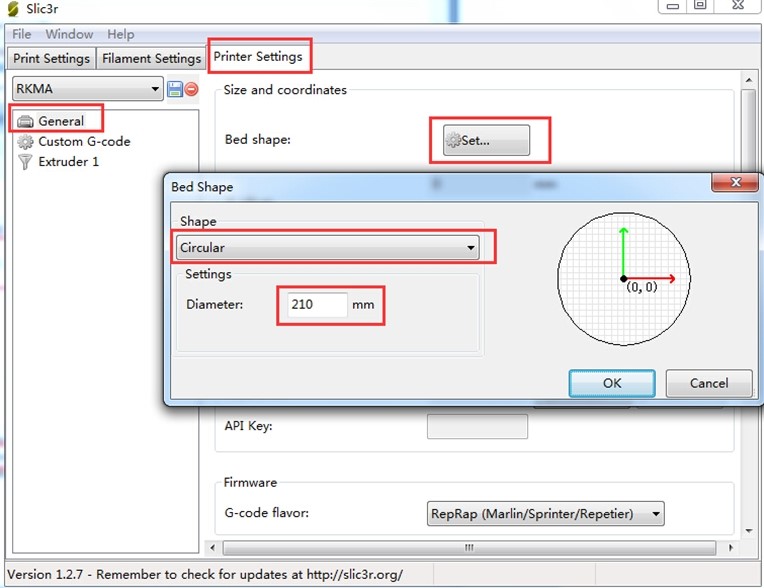

3. Set the correct settings of your printer:

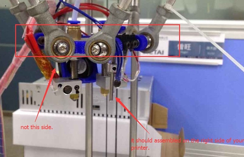

4. Probe endstop should be on the right side of your spider, and make sure the probe can move smoothly through the hole, or it will not trigger the endstop during the G29 and cause the crash.
NOTE: for metal G2S, it should be assembled on the left side!

which firmware do you use? if you use the old firmwrare for plastic G2/G2S, X Y Z should connected to pin1 and pin3; and the new firmware for metal G2 pro/G2S pro, it should be pin1 and pin2 , the same with X Y Zendstops.

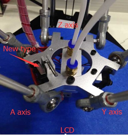

but Pic no.005 (spider/probe) clearly shows another problem.
Loose rod end holders (connection between spider and rods).
First problem here is part design one part has rounded edge, other is sharp. Lucky softer part has the sharp edge.
Once it has some working hours behind it, sharp edge gets eaten away from acceleration forces.This leads to play that is first interpreted as loose bolt.
But after a while this lead to no more room for bolt to go deeper.
Second problem is result of first. Cant re-thigh screw to eliminate rod-end play. Screw is already fully tighten.
If part was bit narrower 1-2mm (so bolt could go bit deeper, not spacing between), there would be more room for the screw once edge gets eaten.
Community has resorted to printing spacers.
this is more quick fix, proper solution would be to match edges on parts.
