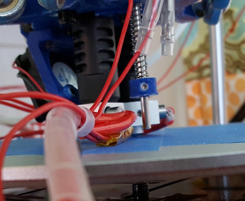

I'm a bit confused about the auto leveling probe. Mine doesn't seem like it could possibly do any good as it is not lower than the nozzles? Did I assemble the nozzels incorrectly?

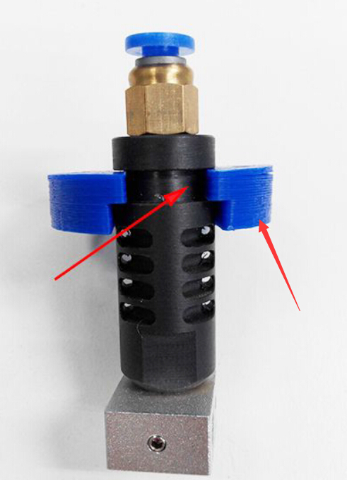

I think you have mounted this bracket upside down...
