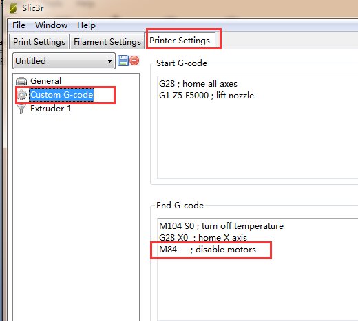

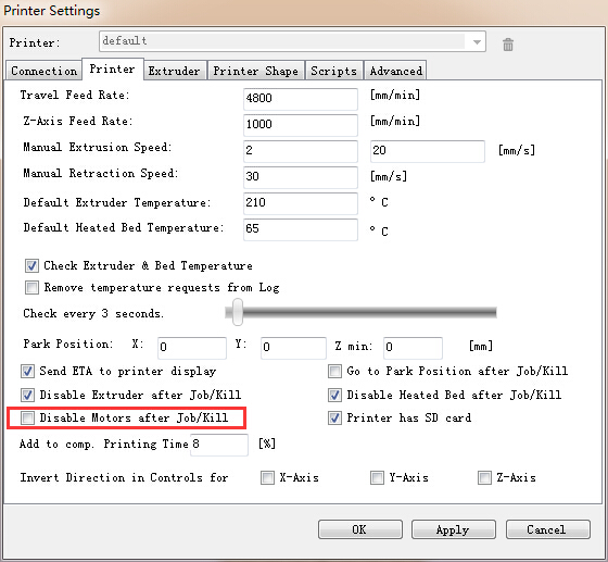

"once the print was over the motors disengaged and the print head crashed into the printing, causing damage to the print. Oops. I need a better ending script."
you can delete the codes here to change this: And don't select the option here:

Thanks Mark!
I did as you suggested. I also added the G29 command so it'd home the print head up to it's top position once finished. I've been getting prints out, and they're not too bad! I have another board coming too, so that should help clear up the last of my problems.
