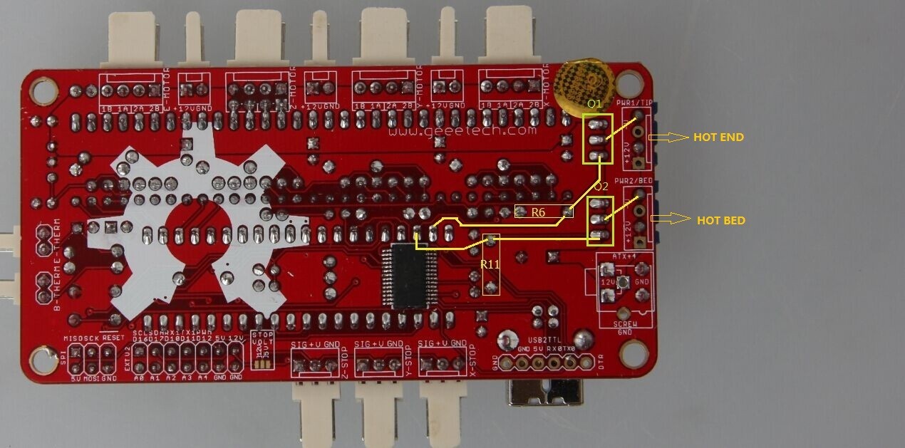

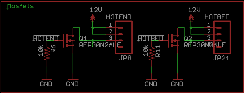

This is the SCH of extruder & hot bed heater
Q1 is hot end mosfet,Q2 is hot bed mosfet.

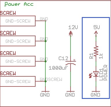

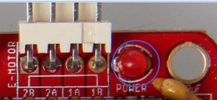

1. Firstly, let us check power supply outputs. Some people use host power supply whose one of output is 5V which can’t support hotend/hotbed to heat obviously.
Then checking whether the 12V DC could power up the mainboard or not.
①Only plug USB without 12V DC, the power LED is lighted.
②Only turn on 12V DC without USB. The LED is lighted as well.
If not,The 12V DC is not turn on or broken;
Or L7805 is broken.
power led.jpg (26.05 KiB) Viewed 44483 times

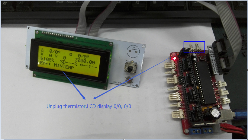

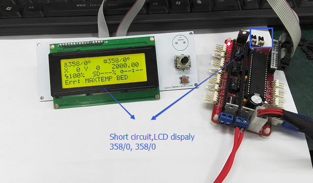

2. Secondly, checking if the mainboard temp reading and thermistors are good. Sometimes the LCD is not sensitive, please reset the LCD panel before reading LCD every time.
1) Make the both thermistor slots open circuit. The LCD will display 0/0, 0/0, MIN TEMP.
open circuit.png (677.32 KiB) Viewed 44483 times
2) Make the both thermistor slots short circuit by plugging jumper caps. The LCD will display 358/0,358/0 , MAXTEMP.
short circuit.png (389.74 KiB) Viewed 44483 times

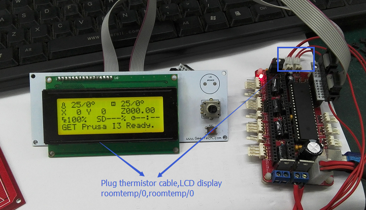

3) Plug thermistors.it will display room temperature/0, room temperature/0.

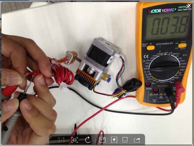

3. Thirdly, let us check whether the resistance of hot bed and hot end are normal.

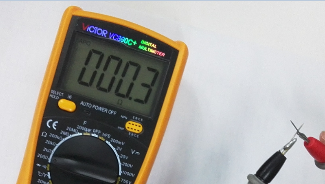

Tip:Please short out the red and black probe at first, you can read a internal resistance. To get a more accurate resistance. The internal resistance should be subtracted from the resistance you measure next.
internal resistance.png (435.02 KiB) Viewed 44483 times
Hot end: it’s resistance is 3.8ohms. 3.8 minus 0.3 is 3.5ohms.
Tip: please let probe tips touch metal carbonyl conducting layer inside insulation material.
hot end resistance.jpg (77.35 KiB) Viewed 44482 times

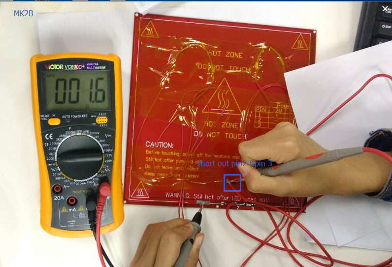

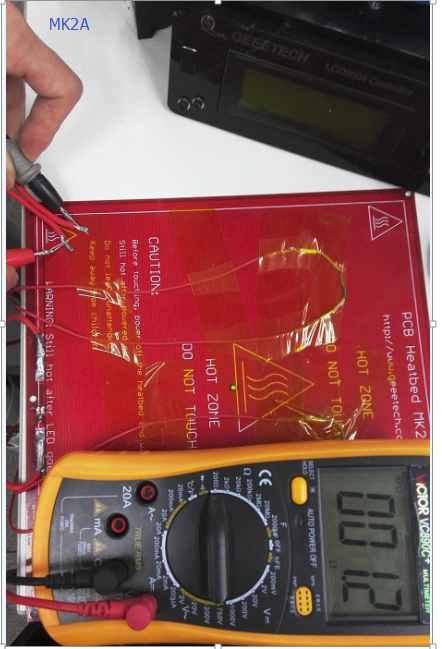

Hot bed: it’s resistance is 1-2ohms.
Here is two type of hot bed: MK2A&MK2B
hot bed(MK2A).png (610.39 KiB) Viewed 44482 times
hot bed(MK2B).png (830.33 KiB) Viewed 44482 times

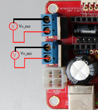

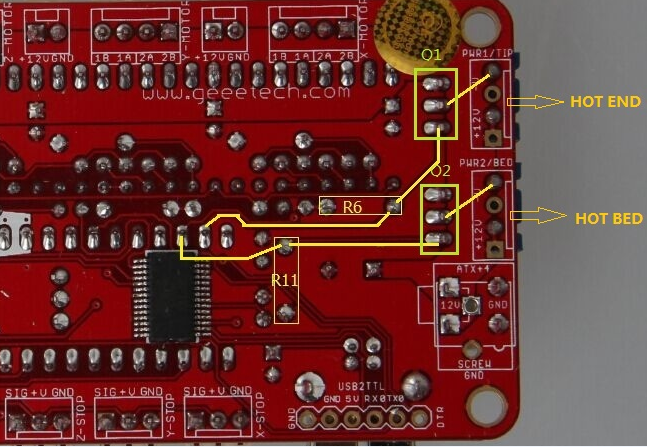

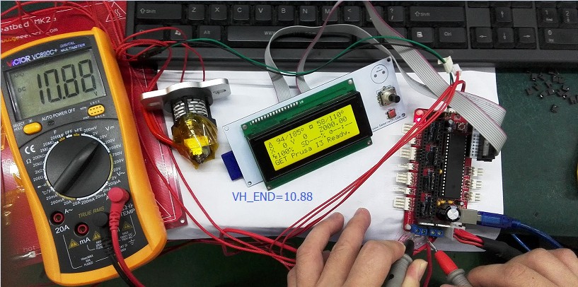

4. Finally, let us check their MOSFETS.
Please plug both hot end heating wire and hot bed’s.
Tip: Make the metal carbonyl conducting layer of heat cables be in good contact with slots. Otherwise the following test will be fail.

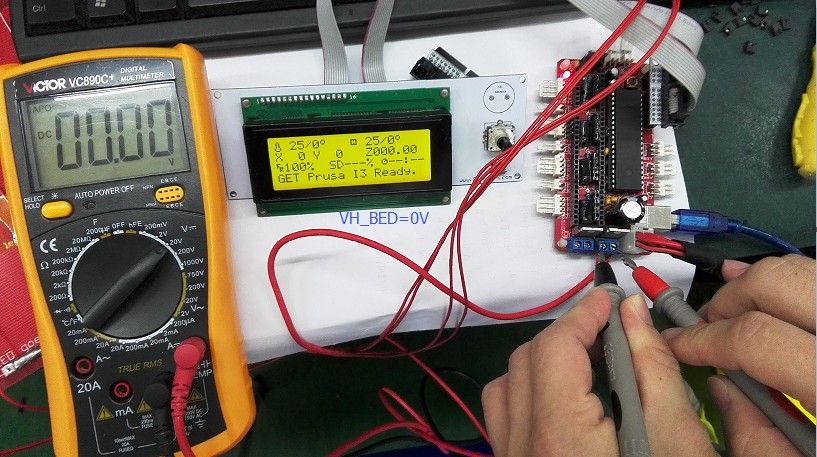

When not heating
VH_END=0V.
VH_BED=0V.
hot bed mosfet(no heating).jpg (130.27 KiB) Viewed 44482 times

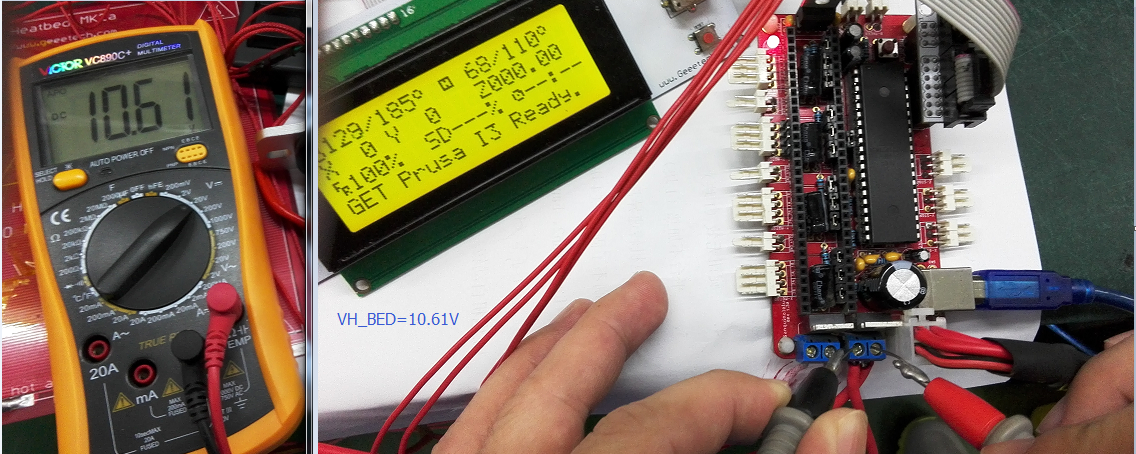

When heating, MOSFET are breakover.
VH_END=10.88V.
VH_BED=10.61V.
hot end mosfet.jpg (128.23 KiB) Viewed 44476 times
hot bed mosfet.png (924.64 KiB) Viewed 42668 times
