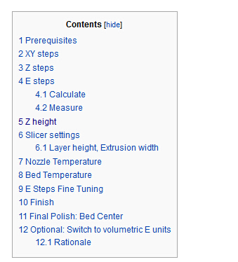

For more details please come to Triffid Hunter's Calibration Guide:
http://reprap.org/wiki/Triffid_Hunter's ... tion_Guide
