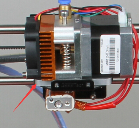

6. metal holder for MK8 extruder x1
7. firmware for I3 PRO C dual extruder printer
And the power, 21A is enough for dual extruder printer, and that will be all.
You can confirm it to the sales in case I miss something.
The metal holder is as the picture shows:
