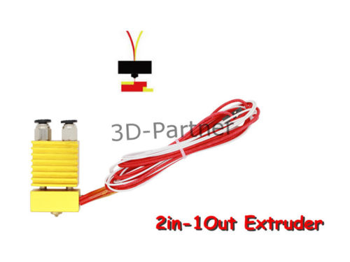

I myself bought 2in 1 hotend
3D printer 2in 1 mixing hotend
2in 1 Extruder.jpg (19.2 KiB) Viewed 19249 times
I mounted it temporary on to G2S 3d printer and tested it couple of times. I will make a new mount for the G2S 3d printer and post STL file on http://www.thingiverse.com/thing:1266600. It is rather tricky to make it work.
2in 1 hotend extruder has one temperature sensor and one heating element. In order to make it work, you have to change marlin firmware. (I will update this post with instructions on what to change) Good instructions you can find: http://reprap.org/wiki/Diamond_Hotend After changing the firmware, I made it work. Now, I am running into the problem with Slic3r generator, or any generator or software printer settings. Manual controls work just fine. Every time I am using two extruders, printer starts working, as long it prints on Extruder1 E0, everything works just fine, as soon as it tries to get to extruder2 E1,the head moves up and out of the printing area and hangs in the air, then continues to print. Need help with that issue. It has something to do with Slic3r. Mark, what settings do you use? Can you plz post your Slic3r config file for 2in 1 hotend extruder?
