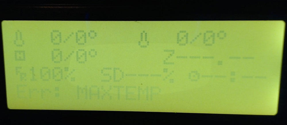

I have a new G2s pro. I've managed to get it assembled despite the instructions missing one or two steps and one captive nut missing on an extruder motor base. I have got the latest firmware source, compiled & uploaded in Arduino.
My actual problem is that as soon as I power it up, either just over USB or with the PSU, I get "Err: MAXTEMP" on the display see attachment

First power on. Err: MAXTEMP
- WIN_20151221_13_59_33_Pro.jpg (82.81 KiB) Viewed 9741 times

Hi Mark,
I'd seen that link. It hadn't helped until I made the following change:
I commented out the over temp check at line 1556 of temperature.cpp (if (current_temperature_raw[1] GE1 maxttemp_raw[1]) max_temp_error(1);)
Now the printer starts up, albeit with the thermistor for heater 2 out of action. I now have movement and good temperature indication on the bed and extruder 1. I swapped the thermistors over (I'd managed to leave them swapped in my previous tests) and the problem remains with heater 2 so I think I have a bad ATD on the board on that channel. It's showing 358º (i.e. ATD value 0) when cold. I guess it may just be possible that there's a short on the connector or similar. Do you agree with my diagnosis?
Regards
Mark

Re: First power on. Err: MAXTEMP
seems correct. Is there any solder bridge on the back of the thermistor connector? or anywhere on the back of the board?
