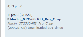

Re: Prusa I3 Dual extruder Configuration+ z go up but not do
you need to download the one for your I3C, not I3 proB,
- QQ截图20151222154727.jpg (42.79 KiB) Viewed 12291 times
