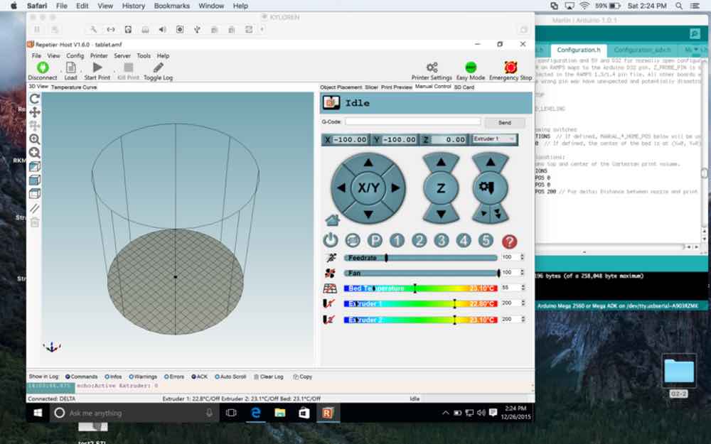

Having trouble. When in the home positions the XY positions are showing -100 and the Z is showing 0. Is this a problem. Trying to calibrate. Here are some screen shots.

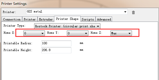

have you set the correct settings here:

Mark that worked... Thanks for the help I'm a newbie... Now on to calibrating
