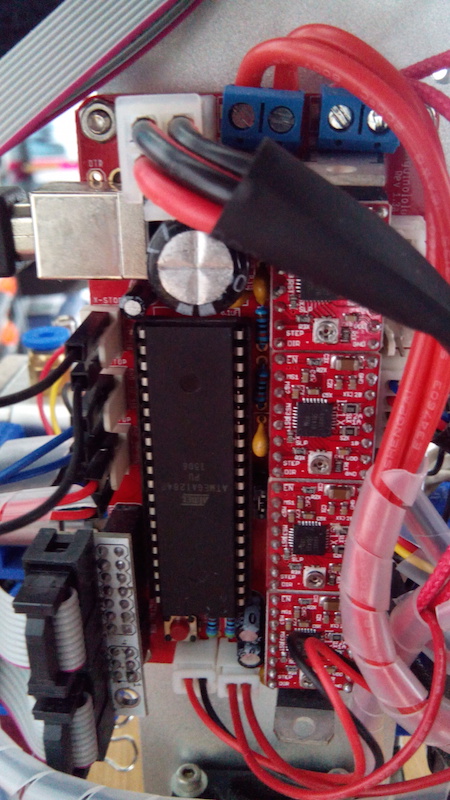

Hi Mark,
I have already replied but maybe the text has been lost. I have checked the board (see the attached images) but to be honest, I have not found any kind of jumper on it.

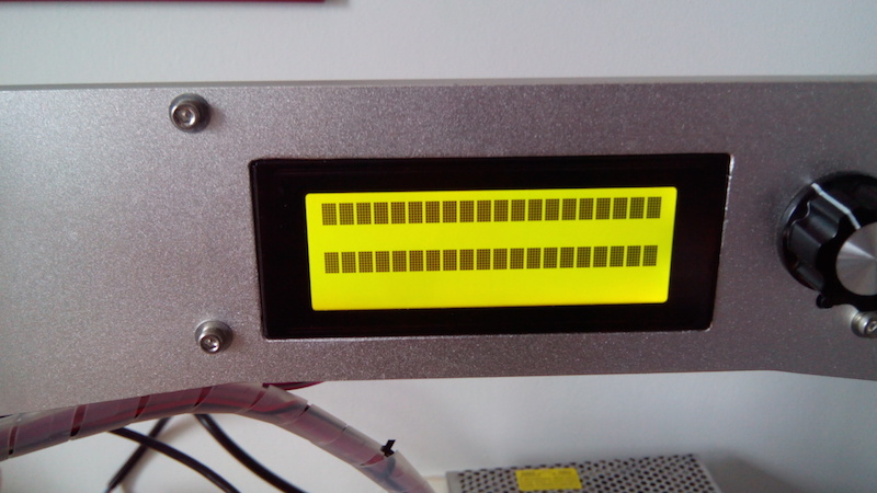

in the meantime, as I have powered-on the Aluminium Prusa i3 now I see that also the LCD display has stopped showing me the info page (see the other attached image).

Today display after booting :(
Aluminium Prusa i3 board with all the connection (that works fine in manual control)

Since you didn't kow the jumper caps, so I guess it's ok, actually it is under the driver, remove it and you'll see it.
As there are 2 rows of blocks on the screen then I think you can try to reinstall the firmware, check this link:

since your printer is working well before, I think it might be something wrong with the mainboard cause the LCD is not working too.
