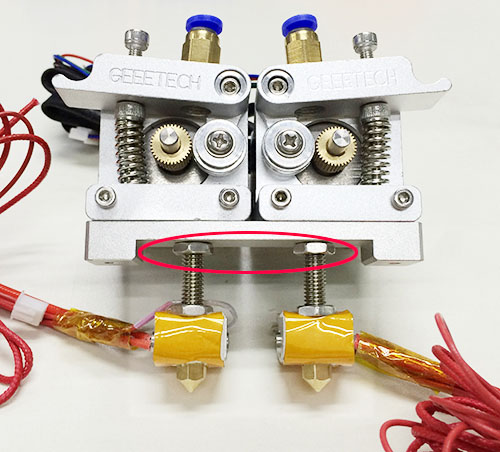

Guys, if you have run into a problem that the nozzle is higher than the extruder carriage after homing, like this one below:
Then don't worry, check the solution here:

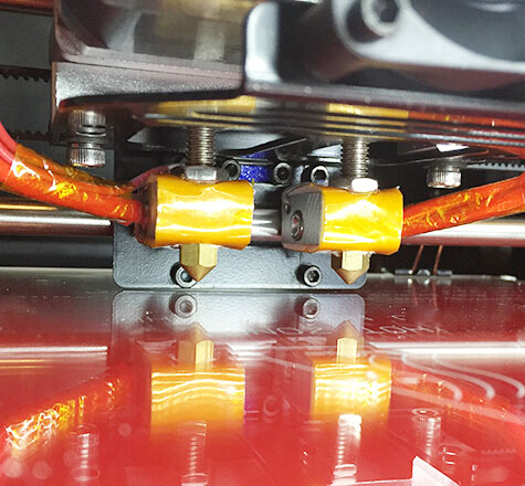

Unscrew the upper nuts on extruder as the picture shows, and then lower down the two hotends to a proper height, and that's all.
But note that don't touch the nut on the heater block if not necessary, or it might leak!
Unscrew the upper nuts, lower down the two hotends to a proper height

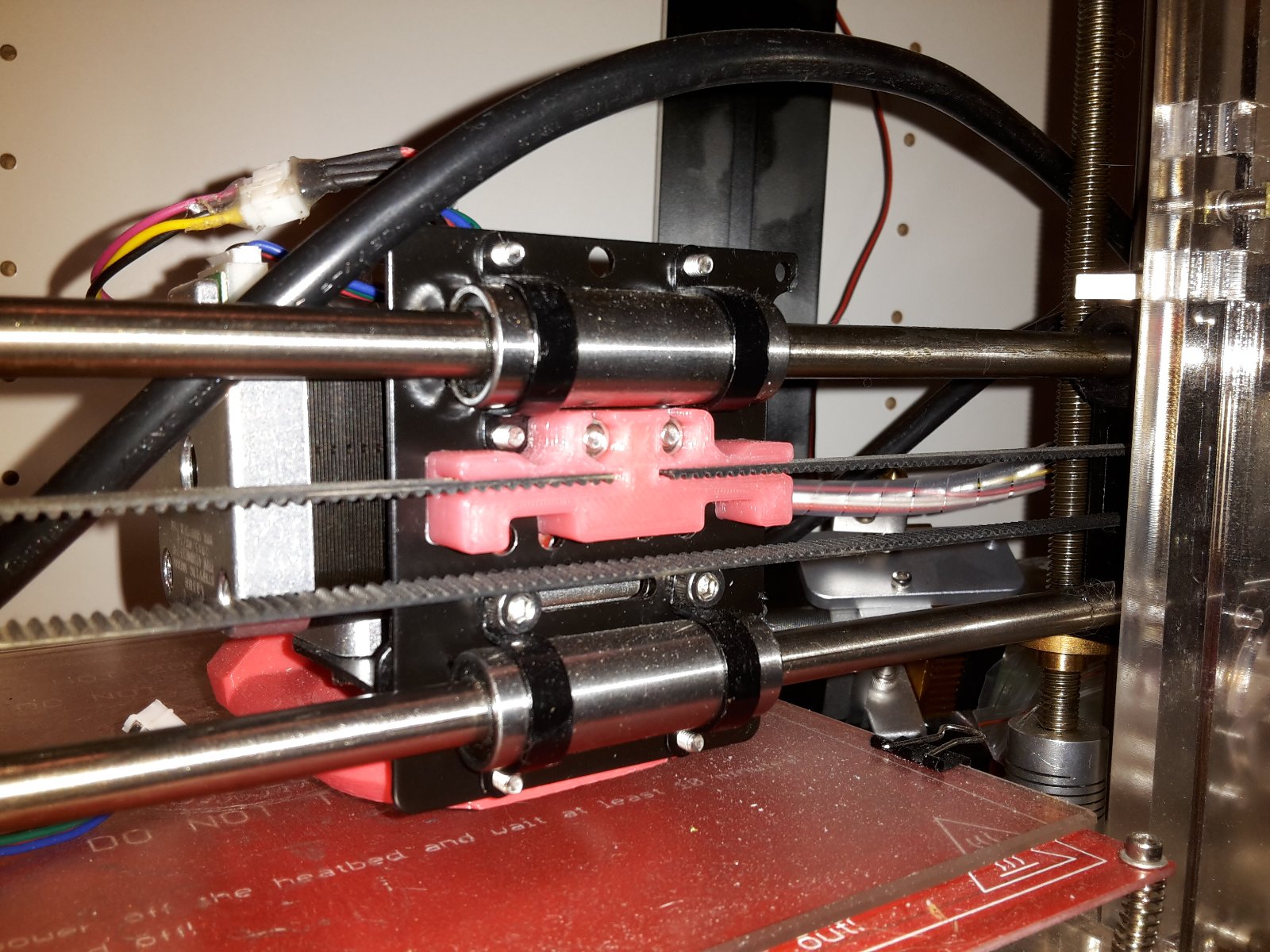

I think this design is faulty, it pass only to very long heatbreak and is a nonsense. But if you tighten the extruder plate with screw of upper side of bottom bearing bracket this will lower entire mounting enough for your.
You see, I used M5x6 screw. Bearing bracket must be drill to 5mm at this point. Be aware, it is not so easy.
