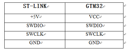

Hi I have finished building my Prusa I3 M201 I want to install the firmware I checked on the forum found how to do it but having difficulty to connect the St-Link to the board. Photo on the forum is not clear and my connector colours is different from the one posted in the forum, my colours are Brown,Red,Orange and Yellow
any help please I do not want to fry my board, could any one post photo showing where the pins connect

wire them as the picture shows:
