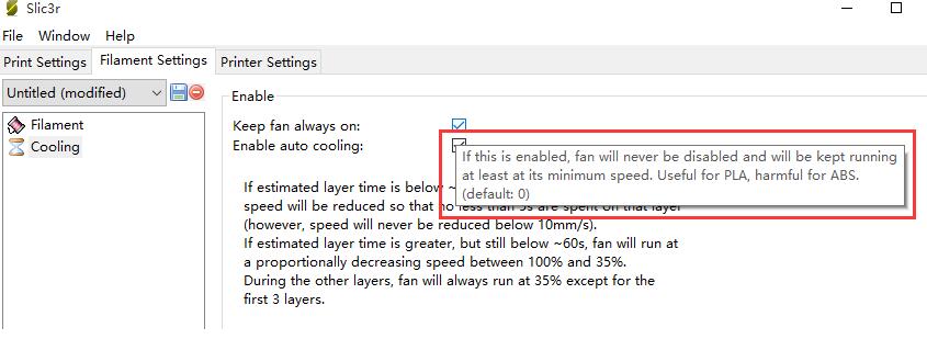

I remember the "0" on the repetier host menu is not the actual 0 speed, you can slow it down but as you said, will not stop.
check this setting:

I don't think it's such case because the fan start rotating as soon I power on the printer, even without pc connected. BTW this setting was already unchecked.

So did you check the slicing setting in the above picture?

I use cura, and i know that setting, anyway when You turn on printer fan should not working in pwm when on LCD You have "0". My is working.
