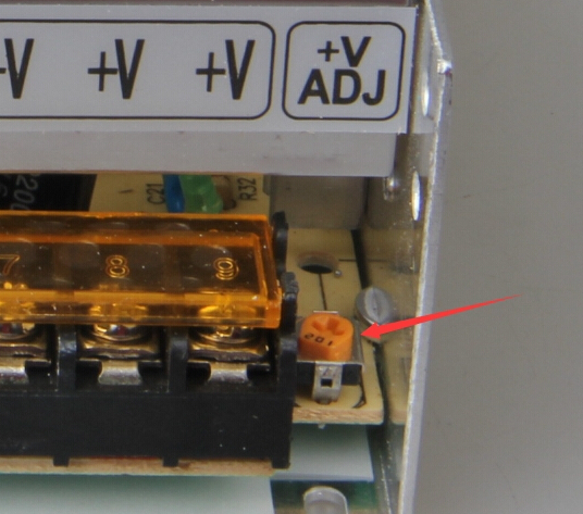

I have an I3X. The voltage from the PSU is around 10 volts. When I activate the bed heater, it goes down to 9 volts. Is this normal ?
The maximum temp I was able to reach was 75 C.
I tried a PC PSU. It maintains 12v in all situation, but the maximum temp I am getting is 108. And it takes more than 30 minutes to get there.
Is this normal ?
This i3x was bought in december.
Thanks!

"It maintains 12v in all situation, but the maximum temp I am getting is 108. And it takes more than 30 minutes to get there."
this is normal,so you need to check your PSU output, did you swith it to the voltage in your own country, 220V or 110V? and if you have done this, how about rotate the trimpot on the PSU to adjust the voltage to about 12V? will it work?

Do we turn it clockwise or counterclockwise? And how do we tell that the voltage has changed?

haven't measured the current before, but just make sure the output is 12V. And you need a multimeter and switch it to the DC 20V or 200V to test it.
