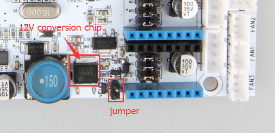

I'm having a similar issue, except none of my fans work, I've even connected 2 new fans to all the fan ports and I'm having no luck. my board is the gt2560 from the pro c.
Mark
Posts: 1553
Re: Control board Fan not turning ON
Post by Mark »
are all your motors work or not? the fan power is directly from the 12V conversion chip, if the motors have 12V then the fan should be on too. Or how about plug a jumper cap here, see the picture below, then the fan will connect directly to the 12V main power:
