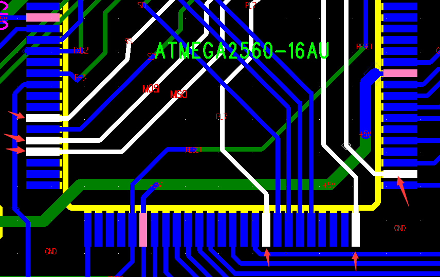

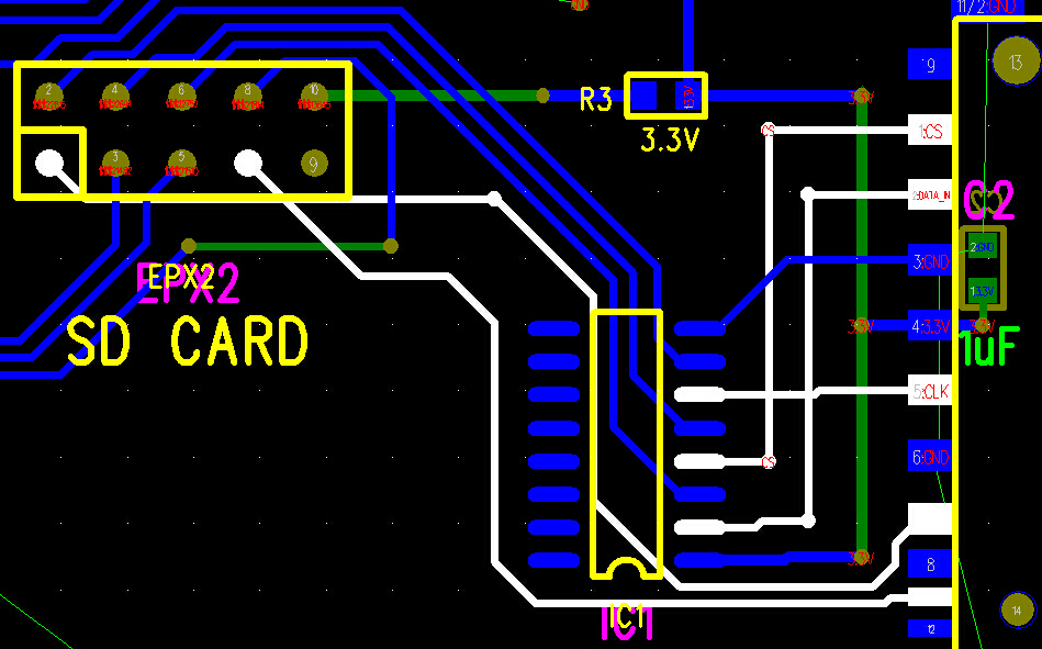

and maybe check the pins of the SD card on the LCD board and the mainchip, see if there a short out between them or not:
Pins on the LCD board:
Pins of the mainchip:
