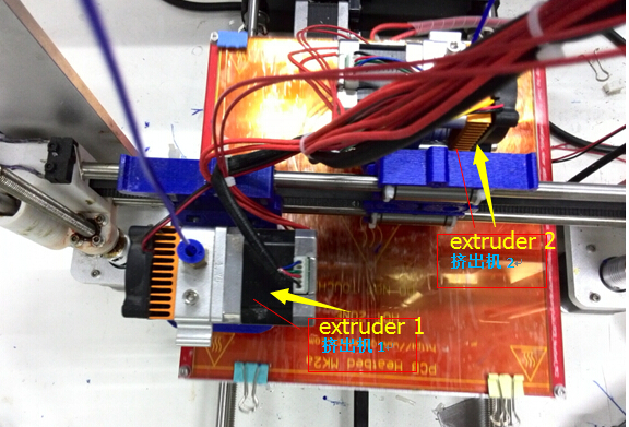

I found a firmware here, it will let the two extruders working at the same time, exactly the one that you want.
Please note the extruder motor direction and test the other functions before print.
And you can also customize your printer as the picture shows to get a better reslut by using two MK8 single extruders:
PI3B-GT2560-2E_copyer.zip
(3.95 MiB) Downloaded 1361 times

Thank you very much Mark. I uploaded the firmware you shared. One problem I got for now is about the direction of extruding motors. When I press extrude in Repetier-Host, the motors actually rotate in other way (retracting). So, I think, I need to change the direction for the extruder motors. Would you please able to tell me how can I do that? Thank you very much.

Hello mark, finally I got my printer working well with the copyer firmware. Many thanks for your awesome help. 2nd extruder does exactly what the 1st extruder does. I am now thinking about using mixing extruder like the one used in Geeetech I3 M201. I was wondering if you could help me telling exactly where (in the firmware) we are commanding 2nd extruder to do the same as 1st extruder? For example, right now the firmware gives us finally extruded material of 50%-50% of both filaments. If I could change the parentage. For instance, If we could direct the 2nd extruder to feed at a half speed of the 1st extruder, it will give us roughly 67%-33% final percentage of extruded material. Thanks again.
